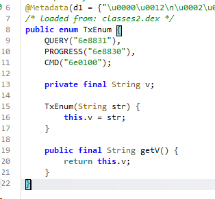

  • 发送前缀:com/richmat/rm/project/mlily0/common/enums/TxEnum.java
    • CMD = "6e0100"
