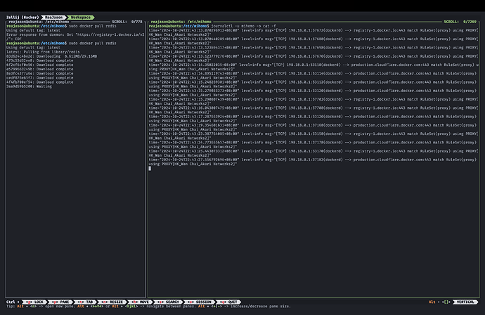

Then use curl to check the mihomo proxy. (if you run systemctl enable mihomo, the computer will start mihomo on startup)
curl -v https://www.google.com
sudo docker pull hello-world

It’s possible that your mihomo service is not running as expected or maybe your proxy is not working, set the log level to debug and check the running logs.
log-level: debug
Reload and check the runing log.
sudo systemctl reload mihomo
sudo jornalctl -u mihomo -o cat -f
