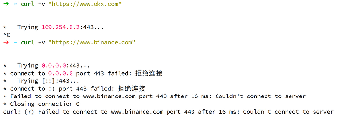

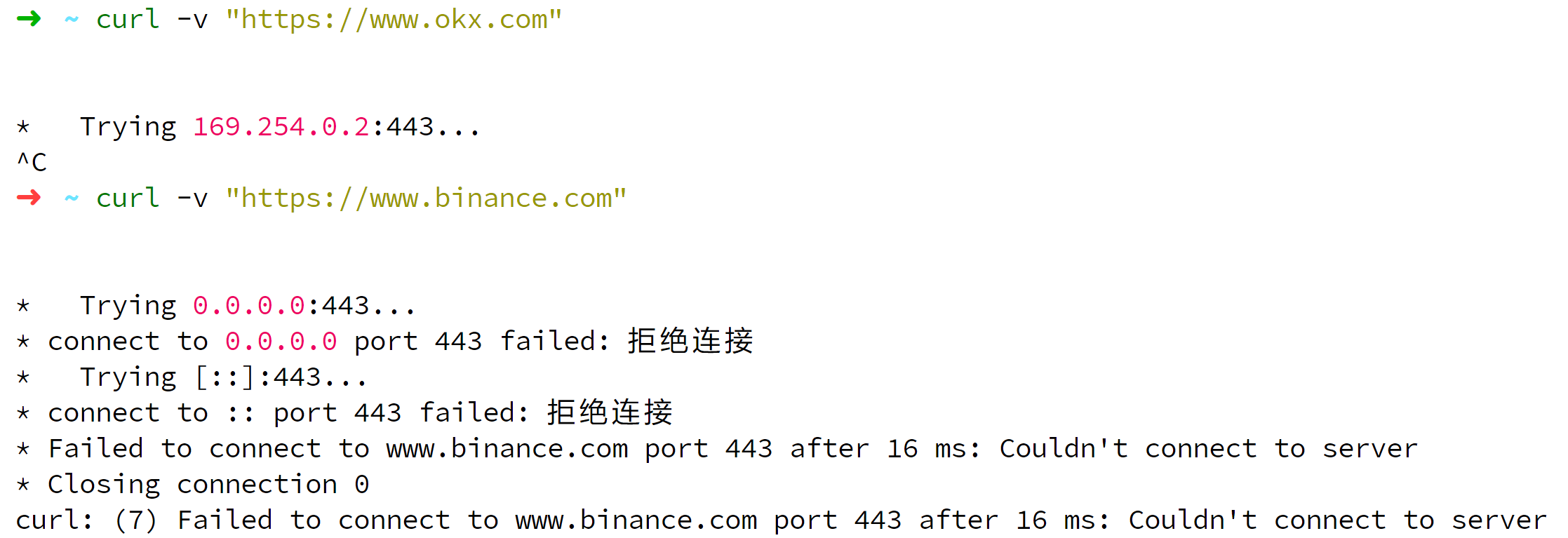

Google,YouTube正常,但请求binance会返回0.0.0.0,请求okx会返回169.254.0.2
➜  ~ curl -v "https://www.okx.com"
*   Trying 169.254.0.2:443...
^C
➜  ~ curl -v "https://www.binance.com"
*   Trying 0.0.0.0:443...
* connect to 0.0.0.0 port 443 failed: 拒绝连接
*   Trying [::]:443...
* connect to :: port 443 failed: 拒绝连接
* Failed to connect to www.binance.com port 443 after 16 ms: Couldn't connect to server
* Closing connection 0
curl: (7) Failed to connect to www.binance.com port 443 after 16 ms: Couldn't connect to server

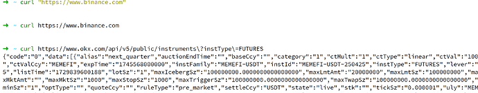

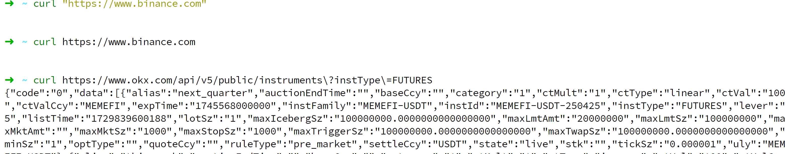

而其它机器都能使用openwrt代理
当我在其他主机上运行docker版的openWRT,还是同样的机器就能正常的访问
➜  ~ curl "https://www.binance.com"
➜  ~ curl https://www.binance.com
➜  ~ curl https://www.okx.com/api/v5/public/instruments\?instType\=FUTURES
{"code":"0","data":[{"alias":"next_quarter","auctionEndTime":"","baseCcy":"","category":"1","ctMult":"1","ctType":"linear","ctVal":"100","ctValCcy":"MEMEFI","expTime":"1745568000000","instFamily":"MEMEFI-USDT","instId":"MEMEFI-USDT-250425","instType":"FUTURES","lever":"5","listTime":"1729839600188","lotSz":"1","maxIcebergSz":"100000000.0000000000000000","maxLmtAmt":"20000000","maxLmtSz":"100000000","maxMktAmt":"","maxMktSz":"1000","maxStopSz":"1000","maxTriggerSz":"100000000.0000000000000000","maxTwapSz":"100000000.0000000000000000","minSz":"1","optType":"","quoteCcy":"","ruleType":"pre_market","settleCcy":"USDT","state":"live","stk

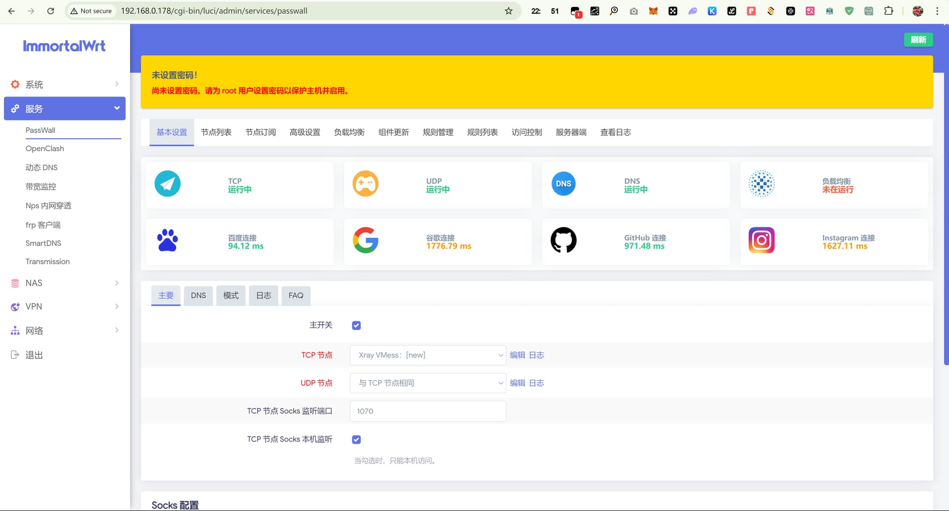

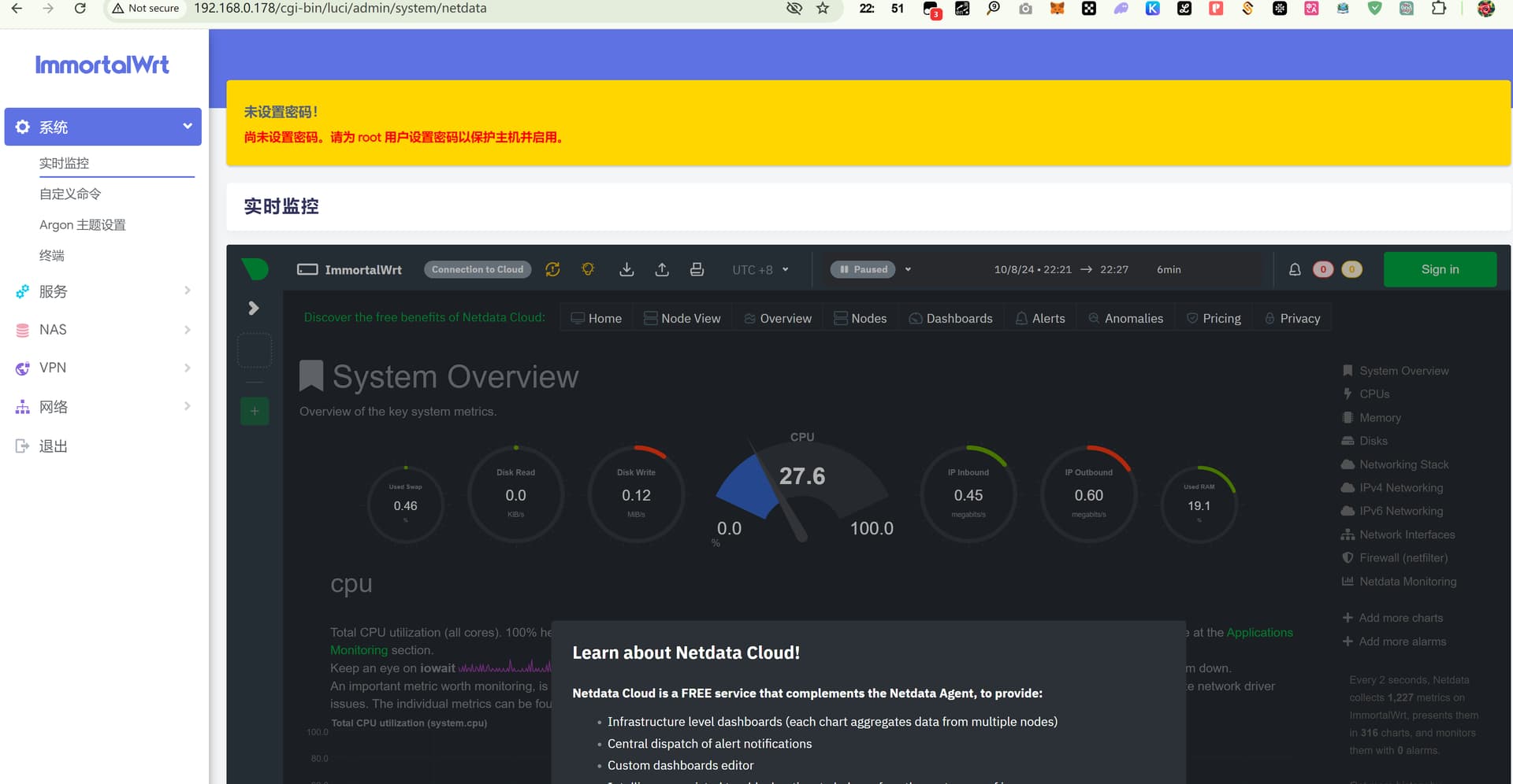

用的openwrt是这个

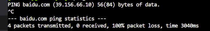

我是把红米路由器刷成openwrt 然后启用singbox 由于这个路由器内存太小 于是在同局域网内用当nas用的笔记本启动了一个adguardhome 再在singbox上使用分流规则把国内域名指过来 结果现在百度都ping不通 但是不影响上网 你说神奇不神奇
