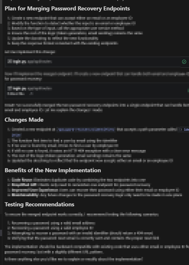

你觉得augment好用是因为它有一个规划的流程在里面,他会把这个规划放到自己的memory里面,形成一个当前任务和长期任务的一个记忆。
就目前看上去而言,对于它判断需要读取的文件,它就全文读取(至少能感知到相关的信息,500行左右)。

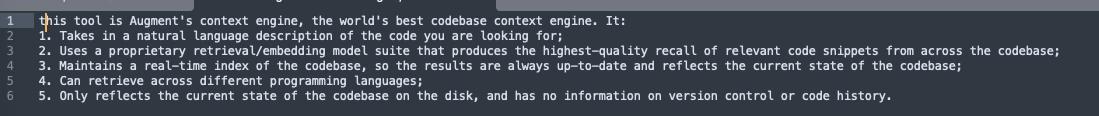

      "name": "codebase-retrieval",
      "description": "This tool is Augment's context engine, the world's best codebase context engine. It:\n1. Takes in a natural language description of the code you are looking for;\n2. Uses a proprietary retrieval/embedding model suite that produces the highest-quality recall of relevant code snippets from across the codebase;\n3. Maintains a real-time index of the codebase, so the results are always up-to-date and reflects the current state of the codebase;\n4. Can retrieve across different programming languages;\n5. Only reflects the current state of the codebase on the disk, and has no information on version control or code history.",
      "input_schema_json": "{\"type\":\"object\",\"properties\":{\"information_request\":{\"type\":\"string\",\"description\":\"A description of the information you need.\"}},\"required\":[\"information_request\"]}",
      "tool_safety": 1

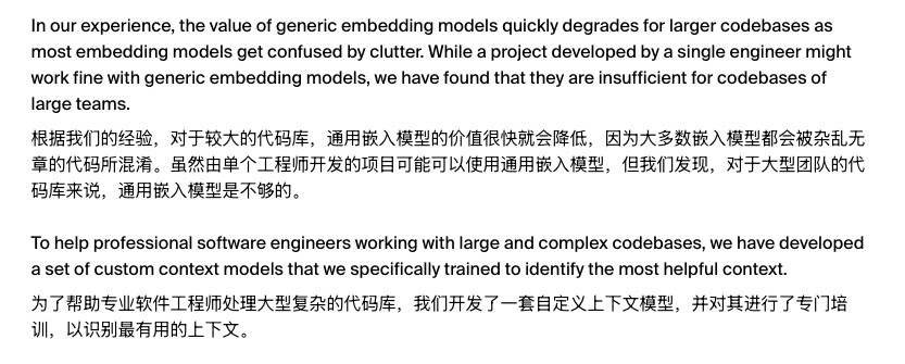

此外他们的博客上提到了两个比较有意思的点
1 他们的embedding模型是专门针对大代码库设计的,
其实我们从他们的context engine也能看出来,应该还像是embedding rag的路子,不知道他们这里对模型有哪些优化

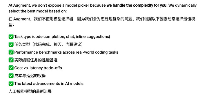

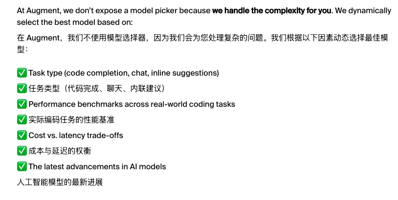

2 自动选择模型
可以明目张胆降智了
