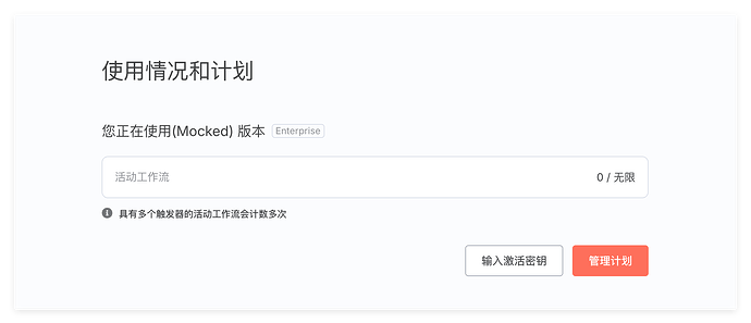

将 n8n 简单汉化了一版,顺便启用了企业版

docker volume create n8n_data
docker run -it --name n8n -p 5678:5678 -e N8N_RELEASE_TYPE=stable -e N8N_DIAGNOSTICS_ENABLED=false -e N8N_VERSION_NOTIFICATIONS_ENABLED=false -e N8N_HIDE_USAGE_PAGE=true -e N8N_LICENSE_AUTO_RENEW_ENABLED=false -e N8N_RUNNERS_ENABLED=true -e NODE_ENV=development -e N8N_DEFAULT_LOCALE=zh-CN -e N8N_ENTERPRISE_MOCK=true -e N8N_SECURE_COOKIE=false -v n8n_data:/home/node/.n8n ghcr.io/deluxebear/n8n:chs
