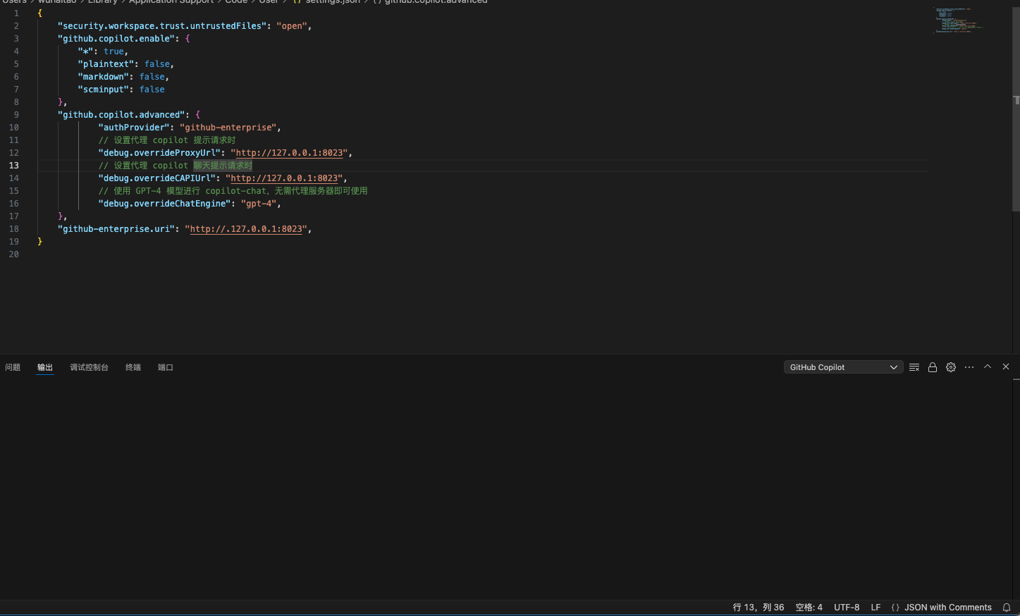

服务启动了然后加上这个之后Vscode得右下角图标就无了这是为什么呢
下面是我config.json的配置
“listenIp”: “0.0.0.0”,
“listenPort”: 8023,
“targetList”: [
“authUrl”: “https://api.github.com/copilot_internal/v2/token”,
“authToken”: “ght_xxxxx”,
“type”: “copilot”,
“httpProxyAddr”: “127.0.0.1:8023”,
“codexUrl”: “https://copilot-proxy.githubusercontent.com/v1/engines/copilot-codex/completions”,
“chatUrl”: “https://api.githubcopilot.com/chat/completions
“authToken”: “sk-xxx”,
“type”: “openai”,
“priority”: 1,
“modelMap”: {
“gpt4”: “text-davinci-003”
“codexUrl”: “https://api-proxy.oaipro.com/v1/completions”,
“chatUrl”: “https://api-proxy.oaipro.com/v1/chat/completions
“local”: “zh_CN”,
“tokenSalt”: “default_salt”,
“adminToken”: “default_admin_token”,
“copilotDebounce”: 1000,
“defaultBaseUrl”: “http://127.0.0.1:8023”,
“apiBaseUrl”: “http://127.0.0.1:8023”,
“originTrackerBaseUrl”: “https://origin-tracker.127.0.0.1:8023”,
“proxyBaseUrl”: “http://127.0.0.1:8023”,
“telemetryBaseUrl”: “https://copilot-telemetry-service.127.0.0.1:8023
感谢老哥解答

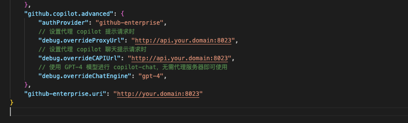

不能直接用127.0.0.1 需要使用域名 没有公网ip的话可以改本地host
嗷嗷明白了 没有域名的话 改host 那config.json和 setting.json都不需要改了是吧 感谢感谢. 因为我直接调用127.0.0.1:xxxx_ping还能调用通 然后我就以为没问题呢 …
