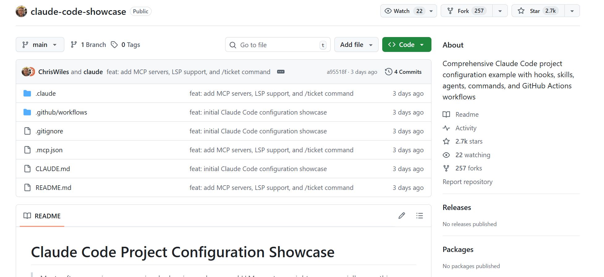

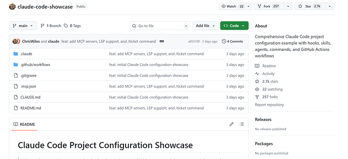

Github上,三天近3k stars
地址这里:
Claude Code Project Configuration Showcase
