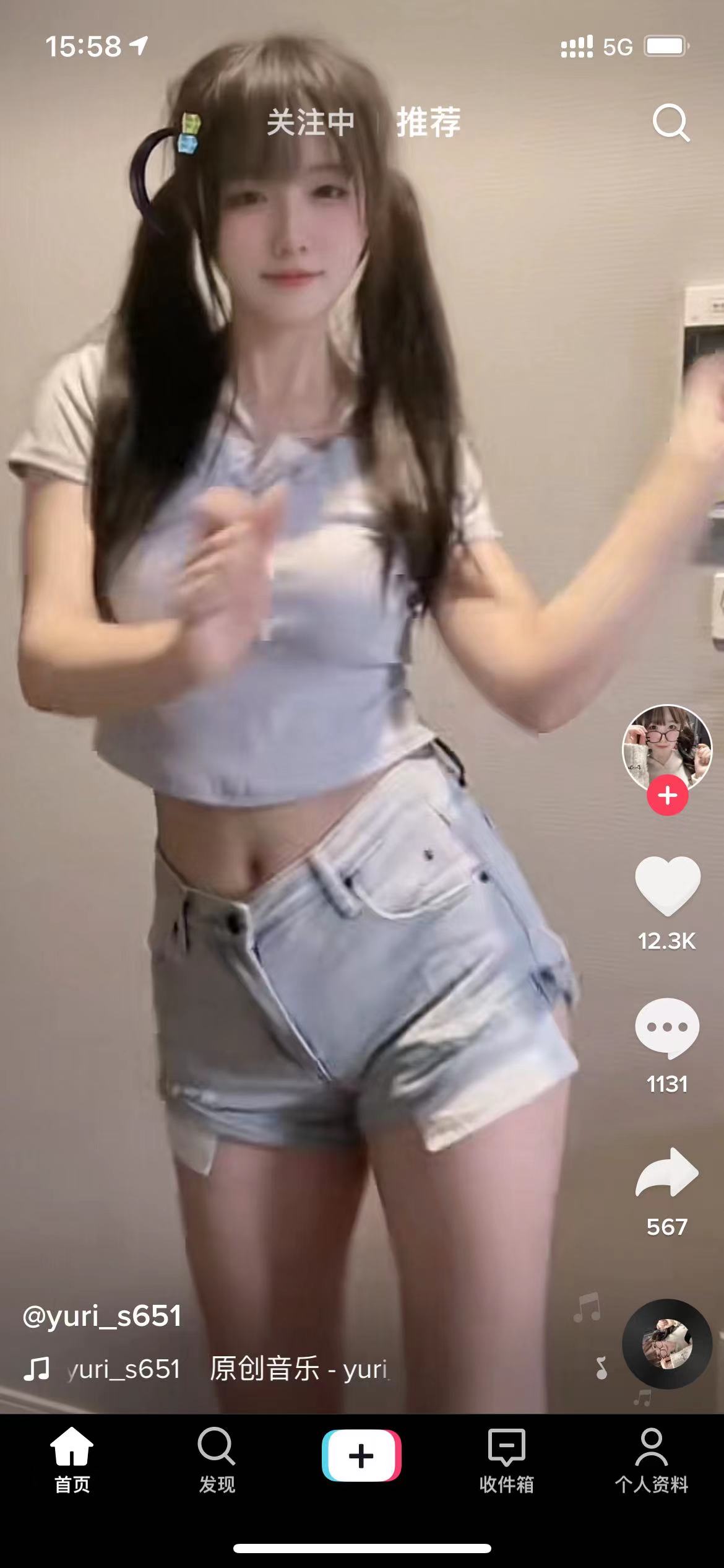

谢谢佬的喂饭教程,我搞定啦,哈哈哈 :hand_with_index_finger_and_thumb_crossed:
