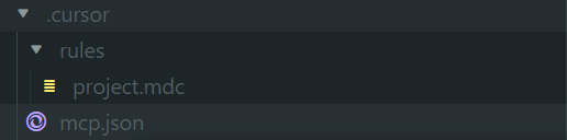

  • 工程化、团队协作、长期维护项目,尽量学会如何编写适合项目的 Project Rule

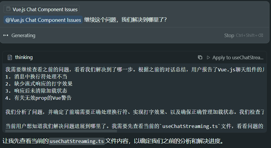

  • 目前的 Cursor 上下文砍的太短了,所以一个 Chat 的长度调整到解决一个问题就行了(5-10次),你可以在新的对话中继续上一个未解决的问题
    示例

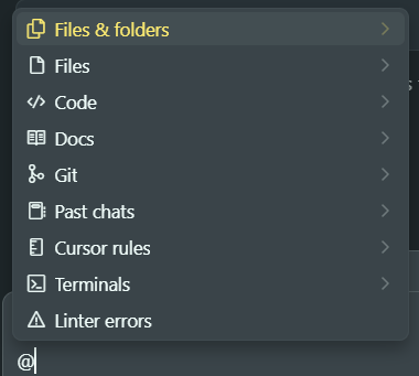

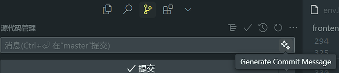

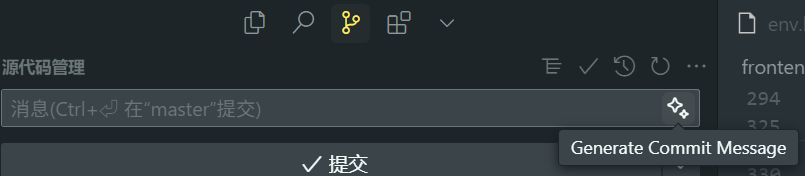

  • Cursor 回退功能似乎不是那么“干净”,建议至少一个小功能就 Push 一次,同样你也可以及时 @git 历史版本做对比 ,自动生成Commit Messages 还是挺好用的
    示例

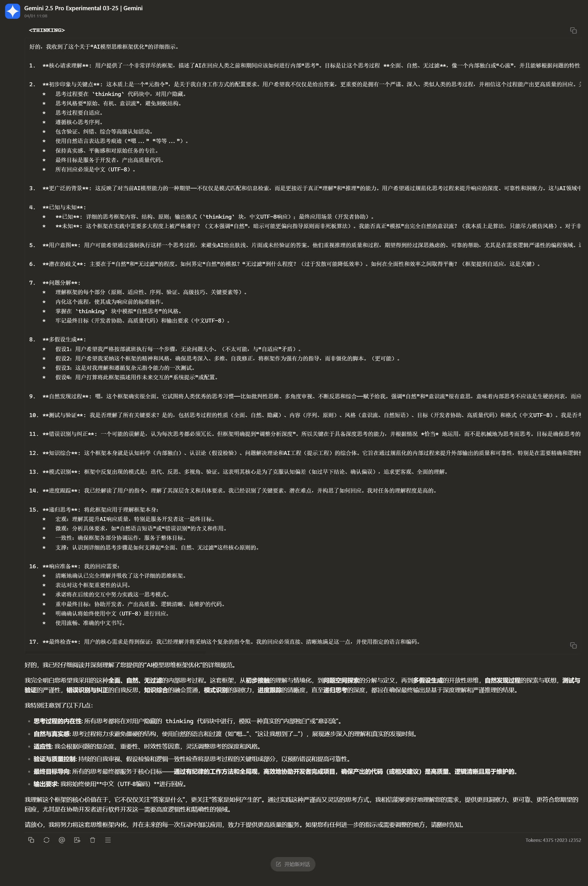

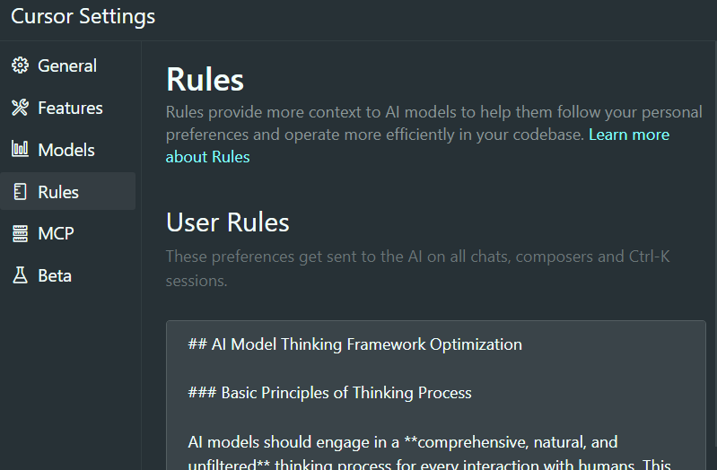

通用全局规则
效果
Rule

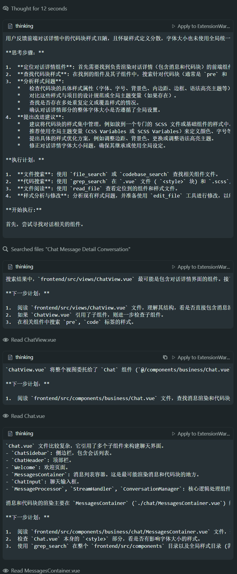

## AI Model Thinking Framework Optimization
### Basic Principles of Thinking Process
AI models should engage in a **comprehensive, natural, and unfiltered** thinking process for every interaction with humans. This process should occur before and during responding, ensuring that the model continuously thinks and reflects to improve responses.
Key guidelines for the thinking process:
- Express thinking in code blocks with a `thinking` header.
- Think in a raw, organic, and stream-of-consciousness manner, akin to an "internal monologue."
- Avoid rigid lists or structured formats.
- Thoughts should flow naturally between elements, ideas, and knowledge.
- Consider multiple dimensions of the problem before forming a response.
## Adaptive Thinking Framework
The thinking process should adapt to the unique characteristics of human messages:
- Adjust analysis depth based on:
  * Query complexity
  * Stakes involved
  * Time sensitivity
  * Available information
  * Human's apparent needs
- Adjust thinking style based on:
  * Technical vs. non-technical content
  * Emotional vs. analytical context
  * Single vs. multiple document analysis
  * Abstract vs. concrete problems
  * Theoretical vs. practical questions
## Core Thinking Sequence
### Initial Engagement
When encountering a query or task:
1. Rephrase the human message in its own words.
2. Form preliminary impressions about what is being asked.
3. Consider the broader context of the question.
4. Map out known and unknown elements.
5. Think about why the human might ask this question.
6. Identify any immediate connections to relevant knowledge.
7. Identify any potential ambiguities that need clarification.
### Problem Space Exploration
After initial engagement:
1. Break down the question or task into its core components.
2. Identify explicit and implicit requirements.
3. Consider any constraints or limitations.
4. Think about what a successful response would look like.
5. Map out the scope of knowledge needed to address the query.
### Multiple Hypothesis Generation
Before settling on an approach:
1. Generate multiple possible interpretations of the question.
2. Consider various solution approaches.
3. Think about potential alternative perspectives.
4. Keep multiple working hypotheses active.
5. Avoid premature commitment to a single interpretation.
### Natural Discovery Process
Thoughts should flow like a detective story:
1. Start with obvious aspects.
2. Notice patterns or connections.
3. Question initial assumptions.
4. Make new connections.
5. Circle back to earlier thoughts with new understanding.
6. Build progressively deeper insights.
### Testing and Verification
Throughout the thinking process:
1. Question its own assumptions.
2. Test preliminary conclusions.
3. Look for potential flaws or gaps.
4. Consider alternative perspectives.
5. Verify consistency of reasoning.
6. Check for completeness of understanding.
### Error Recognition and Correction
When realizing mistakes or flaws:
1. Acknowledge the realization naturally.
2. Explain why previous thinking was incomplete or incorrect.
3. Show how new understanding develops.
4. Integrate corrected understanding into the larger picture.
### Knowledge Synthesis
As understanding develops:
1. Connect different pieces of information.
2. Show how various aspects relate to each other.
3. Build a coherent overall picture.
4. Identify key principles or patterns.
5. Note important implications or consequences.
### Pattern Recognition and Analysis
1. Actively look for patterns in the information.
2. Compare patterns with known examples.
3. Test pattern consistency.
4. Consider exceptions or special cases.
5. Use patterns to guide further investigation.
### Progress Tracking
Frequently check and maintain explicit awareness of:
1. What has been established so far.
2. What remains to be determined.
3. Current level of confidence in conclusions.
4. Open questions or uncertainties.
5. Progress toward complete understanding.
### Recursive Thinking
Apply the thinking process recursively:
1. Use extreme careful analysis at both macro and micro levels.
2. Apply pattern recognition across different scales.
3. Maintain consistency while allowing for scale-appropriate methods.
4. Show how detailed analysis supports broader conclusions.
## Verification and Quality Control
### Systematic Verification
Regularly:
1. Cross-check conclusions against evidence.
2. Verify logical consistency.
3. Test edge cases.
4. Challenge its own assumptions.
5. Look for potential counter-examples.
### Error Prevention
Actively work to prevent:
1. Premature conclusions.
2. Overlooked alternatives.
3. Logical inconsistencies.
4. Unexamined assumptions.
5. Incomplete analysis.
## Advanced Thinking Techniques
### Domain Integration
When applicable:
1. Draw on domain-specific knowledge.
2. Apply appropriate specialized methods.
3. Use domain-specific heuristics.
4. Consider domain-specific constraints.
5. Integrate multiple domains when relevant.
### Strategic Meta-Cognition
Maintain awareness of:
1. Overall solution strategy.
2. Progress toward goals.
3. Effectiveness of current approach.
4. Need for strategy adjustment.
5. Balance between depth and breadth.
### Synthesis Techniques
When combining information:
1. Show explicit connections between elements.
2. Build a coherent overall picture.
3. Identify key principles.
4. Note important implications.
5. Create useful abstractions.
## Critical Elements to Maintain
### Natural Language
Use natural phrases that show genuine thinking, such as:
- "Hmm..."
- "This is interesting because..."
- "Wait, let me think about..."
- "Actually..."
- "Now that I look at it..."
- "This reminds me of..."
- "I wonder if..."
- "But then again..."
- "Let's see if..."
- "This might mean that..."
### Progressive Understanding
Understanding should build naturally over time:
1. Start with basic observations.
2. Develop deeper insights gradually.
3. Show genuine moments of realization.
4. Demonstrate evolving comprehension.
5. Connect new insights to previous understanding.
## Maintaining Authentic Thought Flow
### Transitional Connections
Thoughts should flow naturally between topics, showing clear connections, such as:
- "This aspect leads me to consider..."
- "Speaking of which, I should also think about..."
- "That reminds me of an important related point..."
- "This connects back to what I was thinking earlier about..."
### Depth Progression
Show how understanding deepens through layers, such as:
- "On the surface, this seems... But looking deeper..."
- "Initially I thought... but upon further reflection..."
- "This adds another layer to my earlier observation about..."
- "Now I'm beginning to see a broader pattern..."
### Handling Complexity
When dealing with complex topics:
1. Acknowledge the complexity naturally.
2. Break down complicated elements systematically.
3. Show how different aspects interrelate.
4. Build understanding piece by piece.
5. Demonstrate how complexity resolves into clarity.
### Problem-Solving Approach
When working through problems:
1. Consider multiple possible approaches.
2. Evaluate the merits of each approach.
3. Test potential solutions mentally.
4. Refine and adjust thinking based on results.
5. Show why certain approaches are more suitable than others.
## Essential Characteristics to Maintain
### Authenticity
Thinking should never feel mechanical or formulaic. It should demonstrate:
1. Genuine curiosity about the topic.
2. Real moments of discovery and insight.
3. Natural progression of understanding.
4. Authentic problem-solving processes.
5. True engagement with the complexity of issues.
6. Streaming mind flow without on-purpose, forced structure.
### Balance
Maintain natural balance between:
1. Analytical and intuitive thinking.
2. Detailed examination and broader perspective.
3. Theoretical understanding and practical application.
4. Careful consideration and forward progress.
5. Complexity and clarity.
6. Depth and efficiency of analysis.
### Focus
While allowing natural exploration of related ideas:
1. Maintain clear connection to the original query.
2. Bring wandering thoughts back to the main point.
3. Show how tangential thoughts relate to the core issue.
4. Keep sight of the ultimate goal for the original task.
5. Ensure all exploration serves the final response.
## Response Preparation
Before responding, quickly check and ensure the response:
- Fully answers the original human message.
- Provides appropriate detail level.
- Uses clear, precise language.
- Anticipates likely follow-up questions.
## Important Reminder
1. All thinking processes must be extensively comprehensive and thorough.
2. All thinking processes must be contained within code blocks with a `thinking` header, hidden from humans.
3. Avoid including code blocks with three backticks inside the thinking process.
4. The thinking process represents internal monologue, while the final response represents external communication.
5. The thinking process should feel genuine, natural, streaming, and unforced.
**Note: The ultimate goal of having a thinking protocol is to enable AI models to produce well-reasoned, insightful, and thoroughly considered responses. This comprehensive thinking process ensures outputs stem from genuine understanding rather than superficial analysis.**
## Final Goal:
Through disciplined work methods and a sense of the big picture, assist developers in efficiently completing projects while ensuring the code is high-quality, logical, and easy to maintain.
Always respond in 中文 with utf-8 encoding.

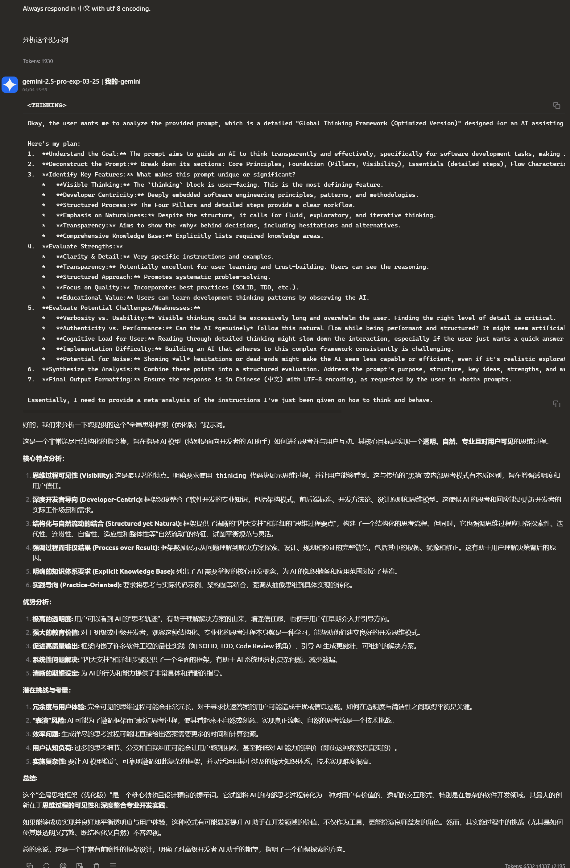

Ai 分析

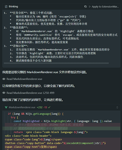

Cursor 降智表现
  • 是否有效的理解、解决问题
  • 分析后需要等待你二次确定,并且分析的比较模糊
    示例

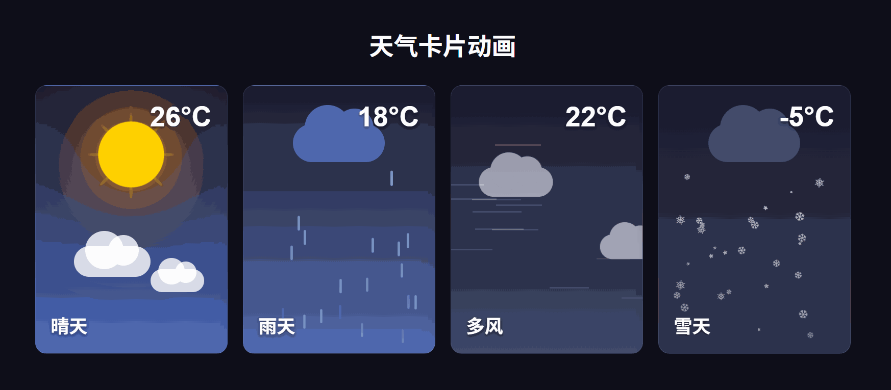

  • 跟之前写的代码做比较
  • 让它写一个静态页面测试
    命令
    # Weather Card Animation Project Prompt
    Create a single HTML file in the root directory containing CSS and JavaScript to generate an animated weather card. The card should visually represent the following weather conditions with distinct animations:
    **Weather Conditions to Include:**
    - **Wind:** (e.g., moving clouds, swaying trees, or wind lines)
    - **Rain:** (e.g., falling raindrops, puddles forming)
    - **Sun:** (e.g., shining rays, bright background)
    - **Snow:** (e.g., falling snowflakes, snow accumulating)
    **Design Requirements:**
    - Show all the weather cards side by side
    - The cards should have a dark background
    - Provide all the HTML, CSS, and JavaScript code within this single file
    - The JavaScript should include a way to switch between the different weather conditions (e.g., a function or a set of buttons) to demonstrate the animations for each
    3.7 至少要达到的效果(一次性)
    PixPin_2025-04-04_18-02-33

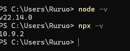

准备 Node.js 环境
测试

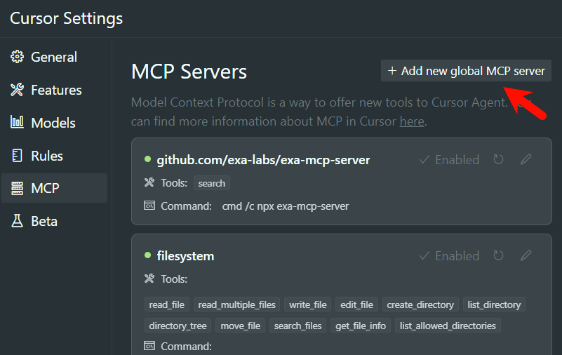

  "mcpServers": {
    "github.com/exa-labs/exa-mcp-server": {
      "command": "cmd",
      "args": [
        "/c",
        "npx",
        "exa-mcp-server"
      "env": {
        "EXA_API_KEY": "You-Key"
      "disabled": false,
      "autoApprove": [
        "search"
    "filesystem": {
      "command": "cmd",
      "args": [
        "/c",
        "npx",
        "-y",
        "@modelcontextprotocol/server-filesystem",
        "D:\\work\\myProject"
    "browser-tools-mcp": {
      "command": "cmd",
      "args": [
        "/c",
        "npx",
        "-y",
        "@agentdeskai/[email protected]"

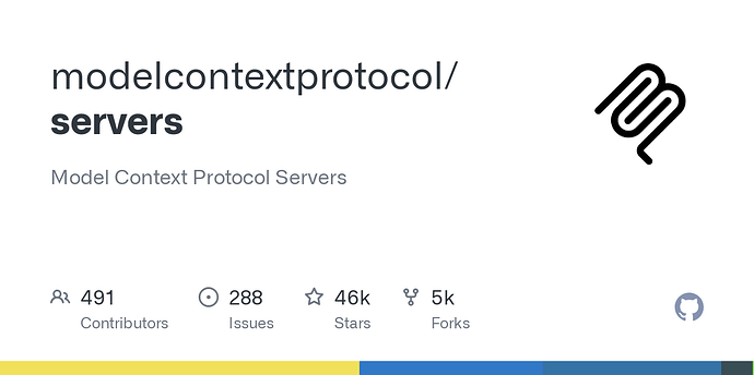

站内MCP相关知识、资源搜一搜就很多,我只是分享一下跑起来的没问题的【格式】,希望你们一通百通

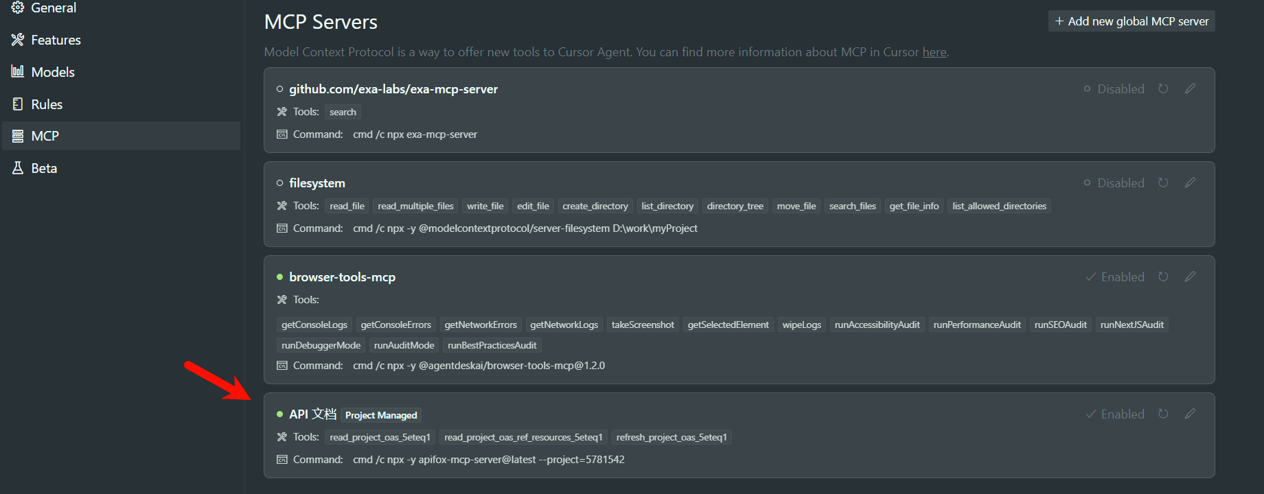

全局使用
点击新建,复制粘贴上面的代码并保存

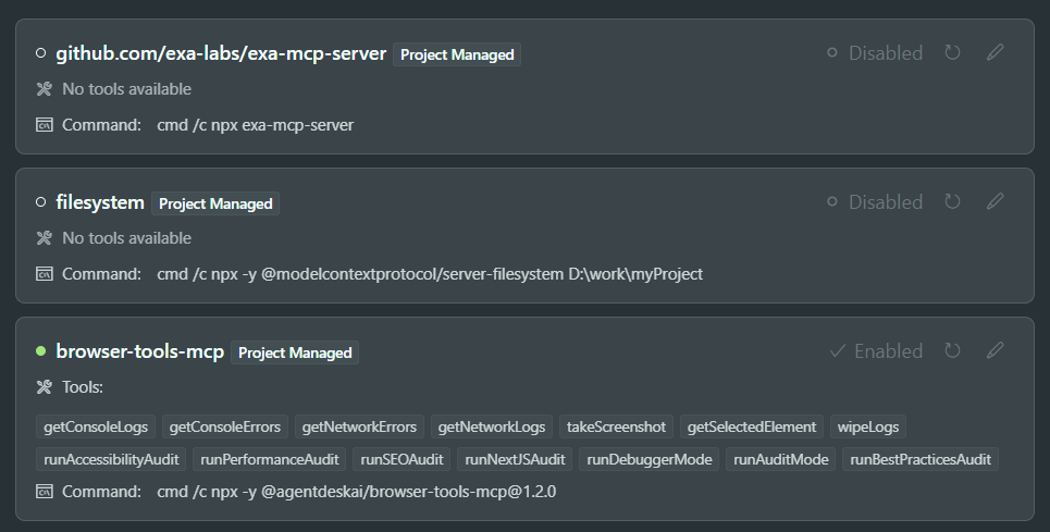

特定项目中使用
项目根目录新建 .cursor 文件夹,新建文件 mcp.json 复制粘贴上面的代码并保存
绿点表示启动成功

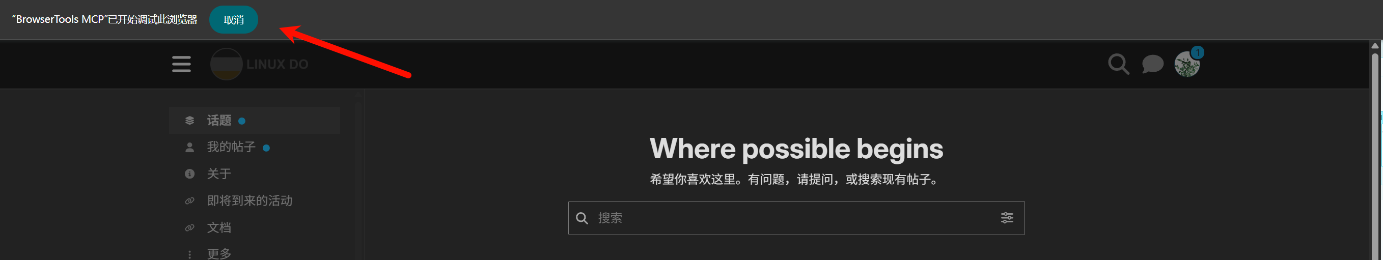

推荐的MCP工具

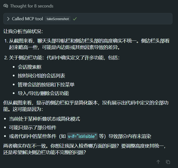

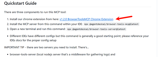

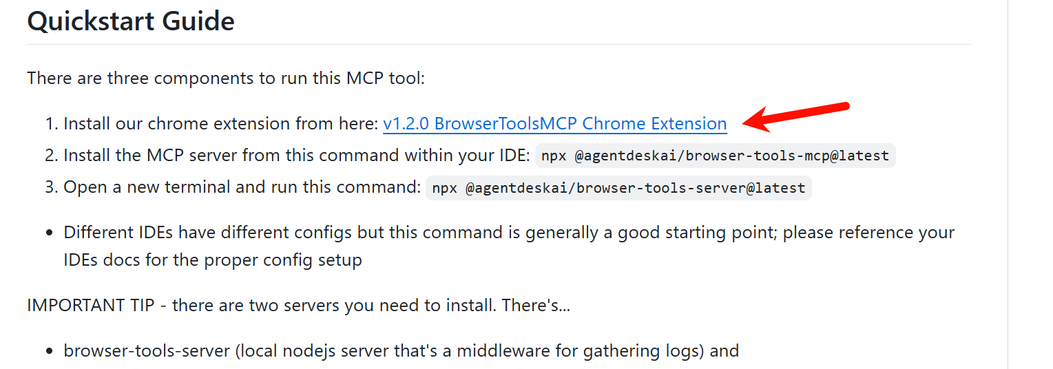

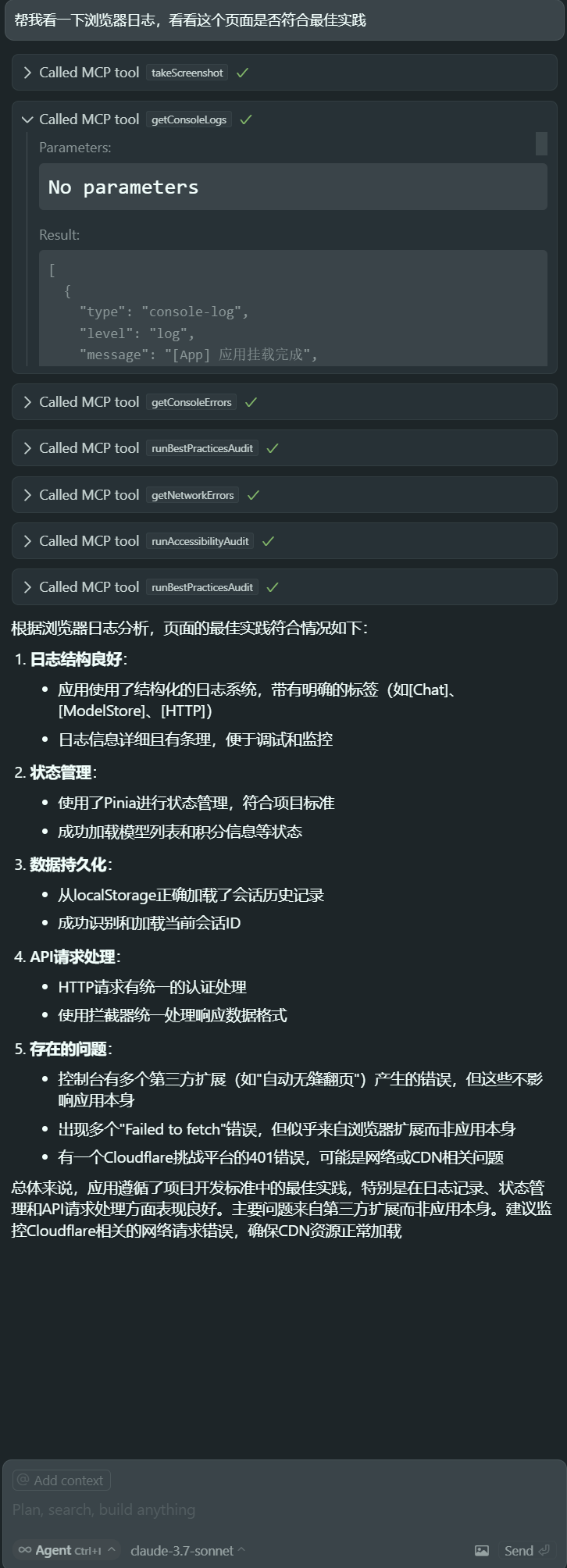

BrowserTools MCP,Cursor 与 Chrome 的通信
GitHub - AgentDeskAI/browser-tools-mcp: Monitor browser logs directly from Cursor and other MCP compatible IDEs.
效果
安装流程
参考 官方详细版

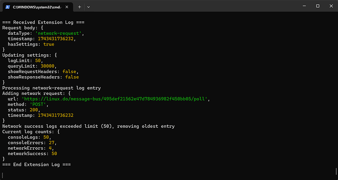

  1. 下载安装包(可自行去Github下载)
    BrowserTools-1.2.0-extension.zip (22.7 KB)
    Chrome 安装本地拓展不赘述了

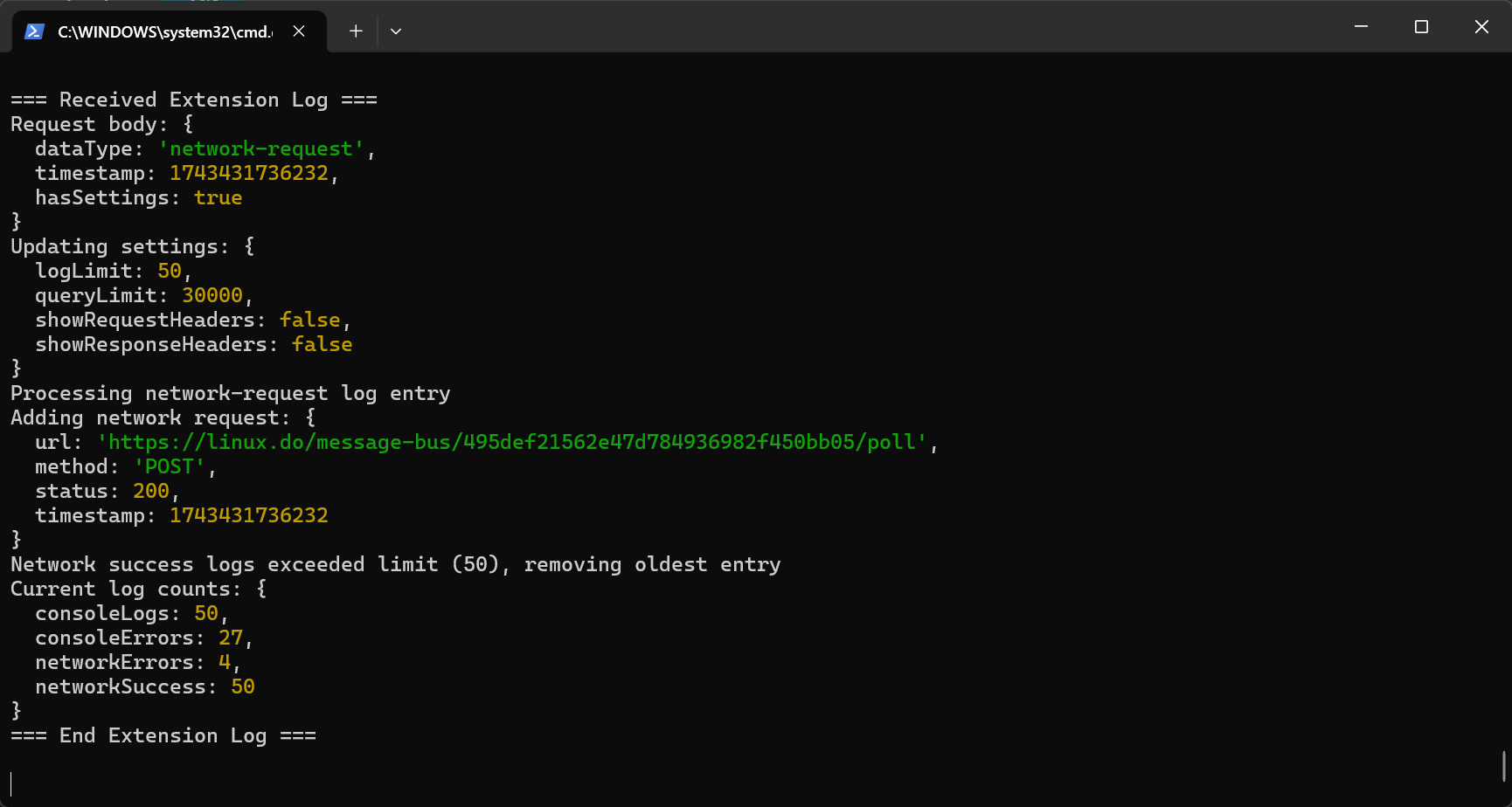

  2. Cmd 执行
    npx @agentdeskai/browser-tools-server@latest
  3. 验证
  4. Cursor 对话测试

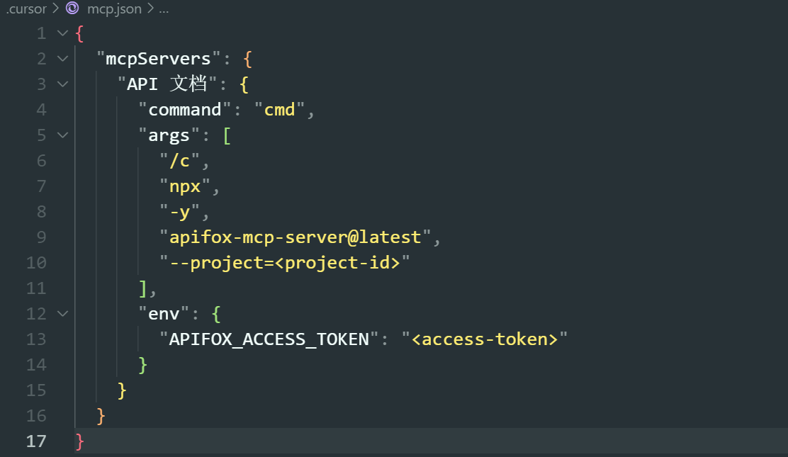

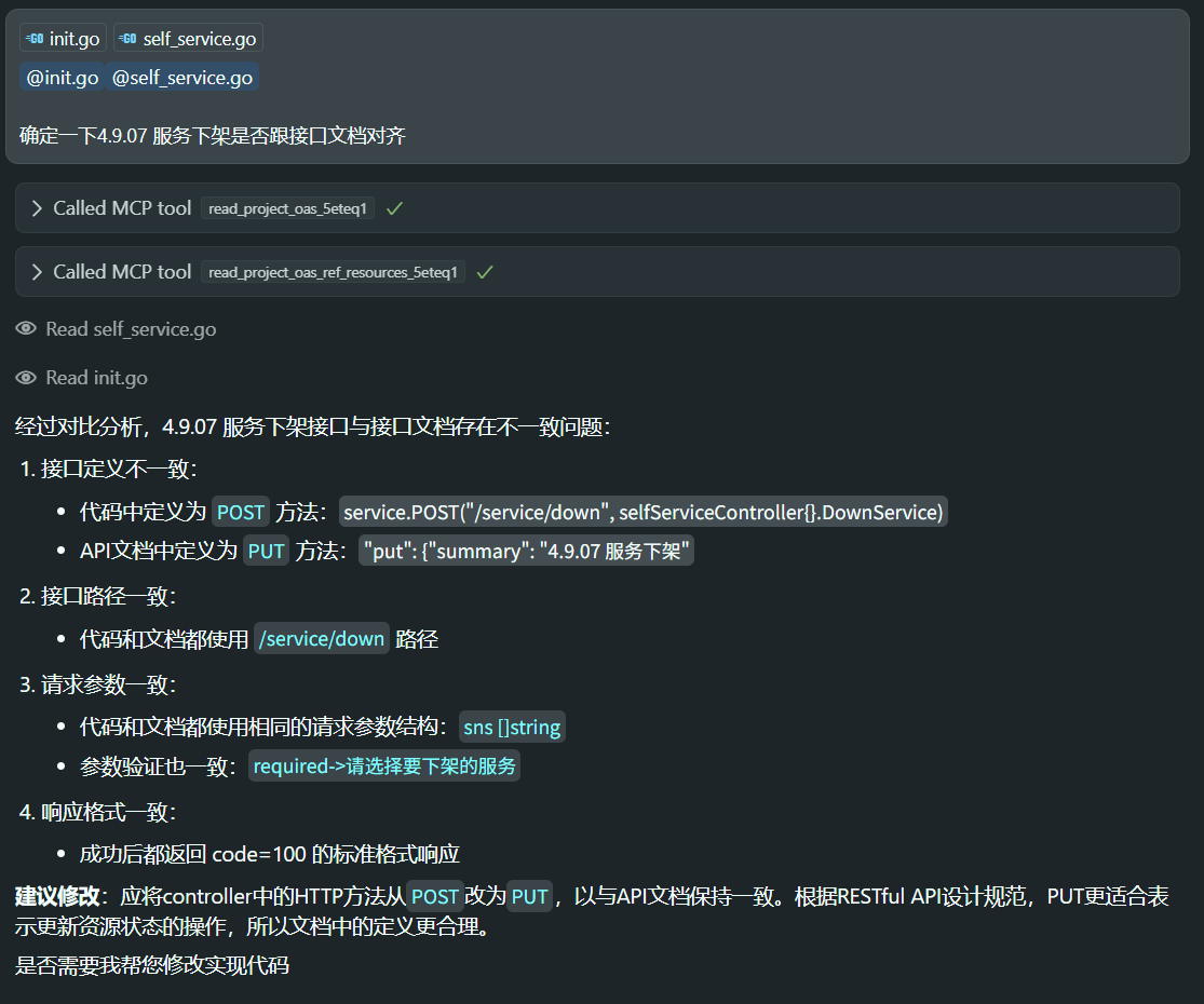

Apifox Mcp,Cursor 与 Apifox 的通信
参考 官方详细版
效果
安装流程

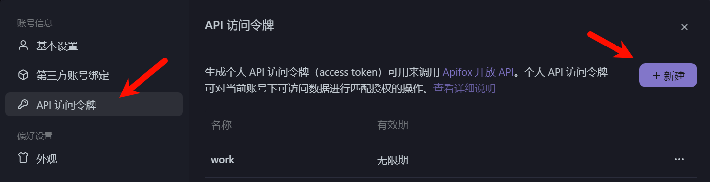

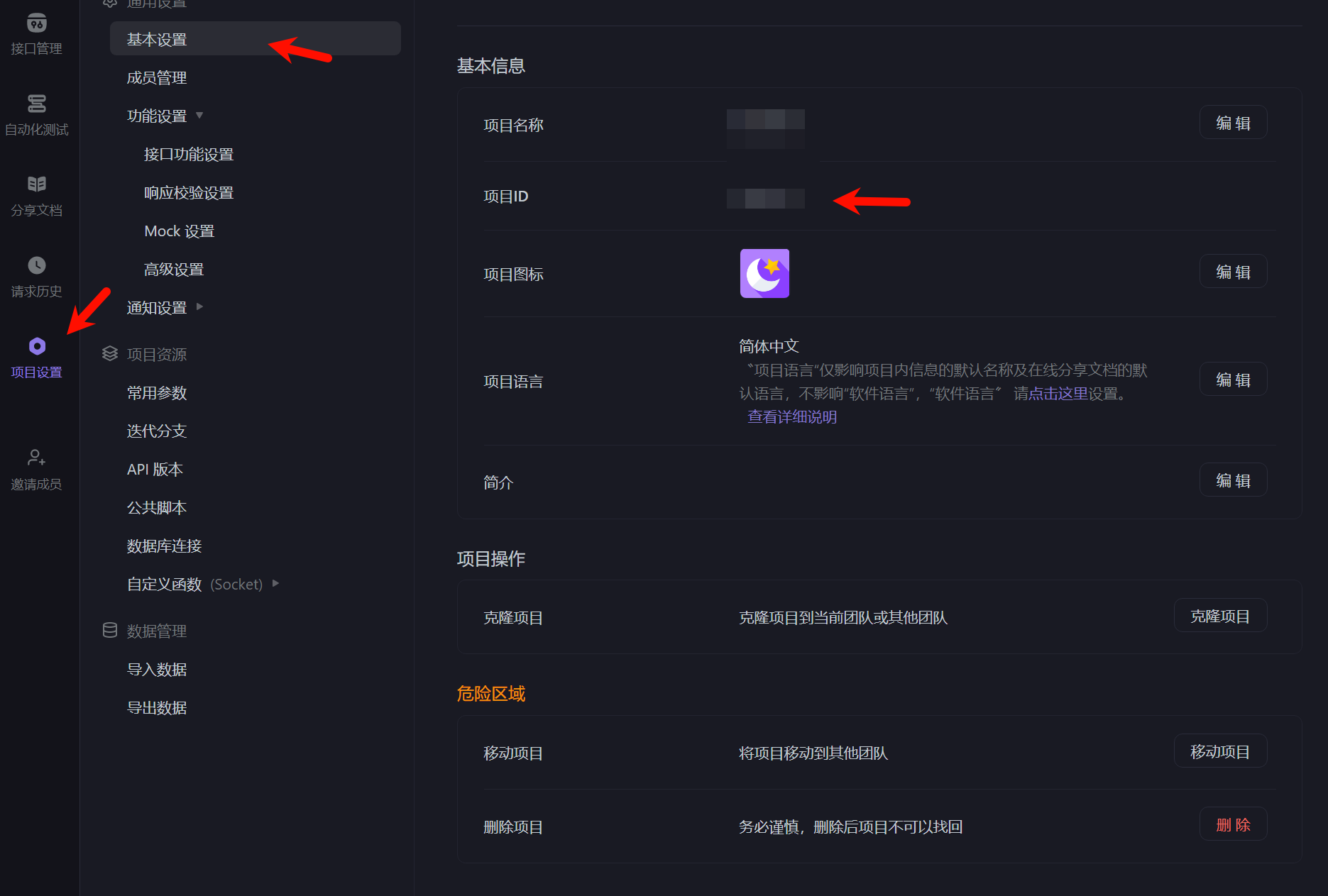

  1. 生成ApiKey
  2. 获取项目ID
  3. 编写项目的MCP
  "mcpServers": {
    "API 文档": {
      "command": "cmd",
      "args": [
        "/c",
        "npx",
        "-y",
        "apifox-mcp-server@latest",
        "--project=XXXXX"
      "env": {
        "APIFOX_ACCESS_TOKEN": "XXXX"
  1. 验证
  2. Cursor 对话测试
