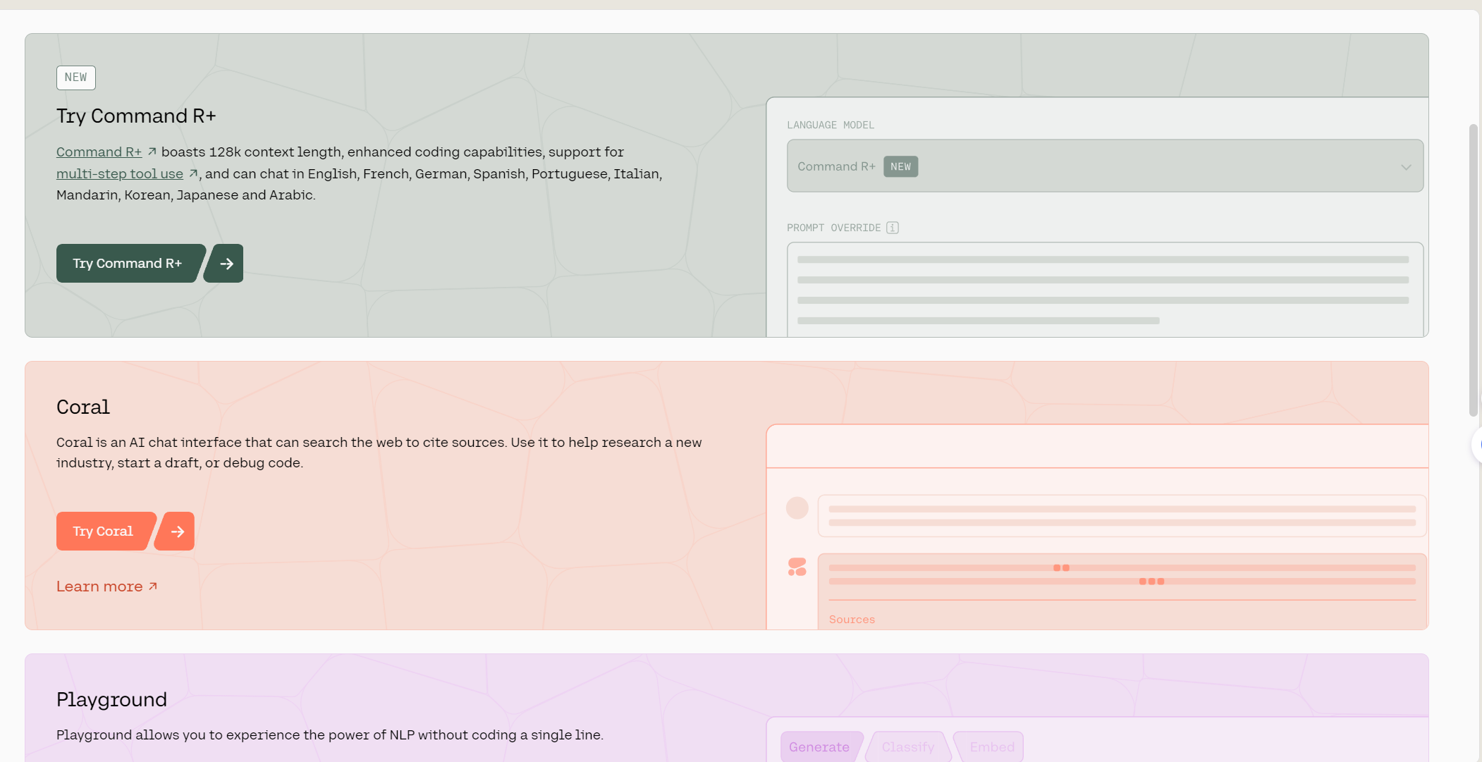

Command R+模型介绍:

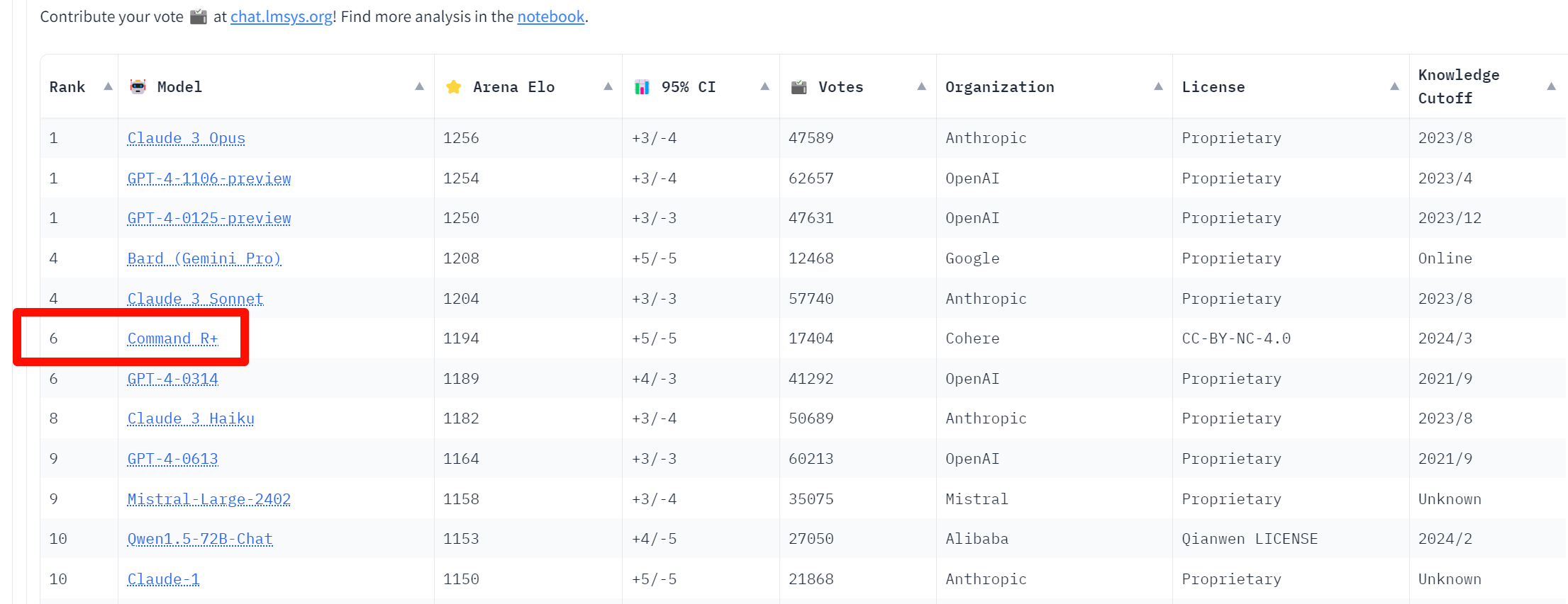

昨天浅试了一下,感觉 roleplay 比 gpt-3.5 和 gemini-pro要好一些.(当然yyds还是gpt-4-1106 和 claude-opus)。

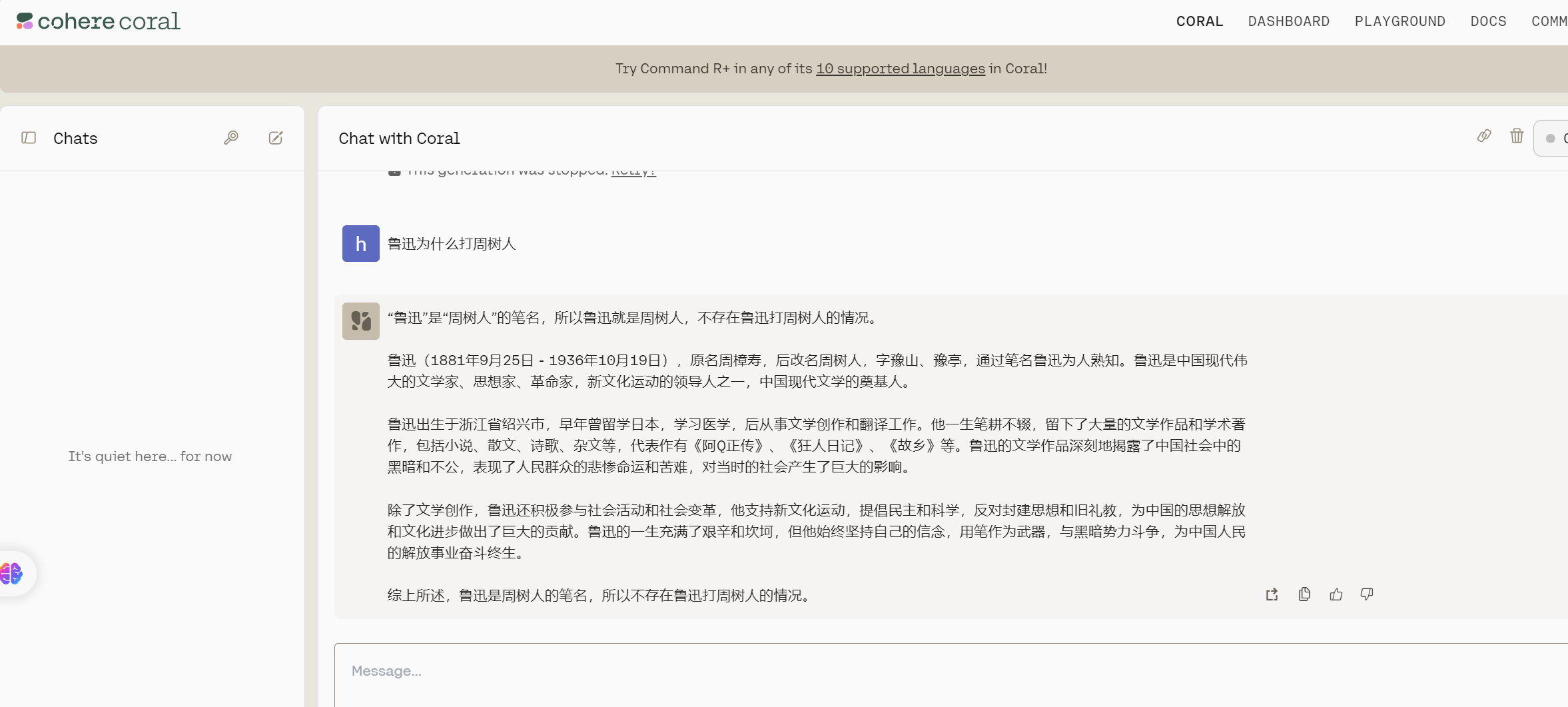

试用 key rate lmited 出现了,1000 API calls / month :
{"message":"You are using a Trial key, which is limited to 1000 API calls / month. You can continue to use the Trial key for free or upgrade to a Production key with higher rate limits at 'https://dashboard.cohere.com/api-keys'. Contact us on 'https://discord.gg/XW44jPfYJu' or email us at [email protected] with any questions"}
试用的API key 用完以后,web端的chat试用也不能用了,因为web端也是用默认的试用api-key 请求的,新建一个key也不能解除限制。
