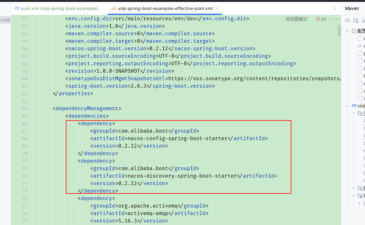

问题:
xinji-spring-boot-dependencies 中 dependencyManagement 中维护的依赖在 xinji-spring-boot-examples POM 中找到不version。
加载项目报错:
com.alibaba.boot:nacos-config-spring-boot-autoconfigure:jar:unknown was not found in https://maven.aliyun.com/repository/public during a previous attempt. This failure was cached in the local repository and resolution is not reattempted until the update interval of alimaven has elapsed or updates are forced
奇怪的地方:
  1. xinji-spring-boot-examples 有效 POM 的 dependencyManagement 是有的
  2. spring-boot-dependencies 中依赖都正常

我维护的是(是xxx-starter)
   <dependencyManagement>
        <dependencies>
            <!-- nacos 配置中心 -->
            <dependency>
                <groupId>com.alibaba.boot</groupId>
                <artifactId>nacos-config-spring-boot-starter</artifactId>
                <version>${nacos-spring-boot.version}</version>
            </dependency>
        </dependencies>
    </dependencyManagement>
然后我examples中引入的是(是xxx-autoconfigure)
    <dependencies>
        <dependency>
            <artifactId>nacos-config-spring-boot-autoconfigure</artifactId>
            <!-- <version>0.2.12</version> -->
        </dependency>
    </dependencies>
被自己蠢哭了
