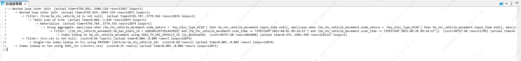

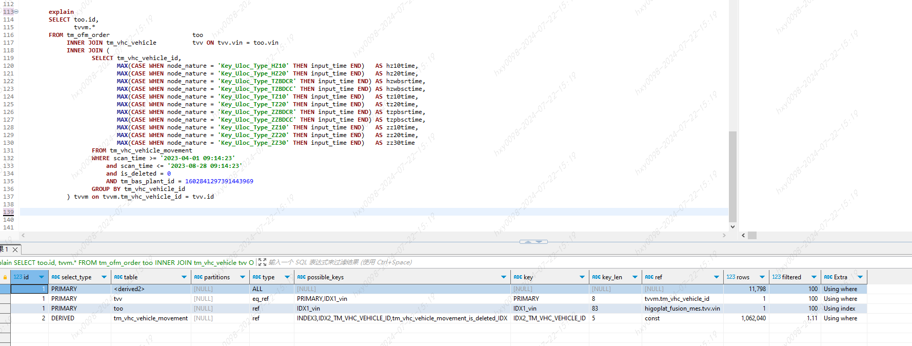

如下是 SQL解析
下面是具体内容
-> Nested loop inner join  (actual time=5765.841..5906.310 rows=11867 loops=1)
    -> Nested loop inner join  (actual time=5765.814..5843.334 rows=12071 loops=1)
        -> Filter: (tvvm.tm_vhc_vehicle_id is not null)  (actual time=5765.787..5779.942 rows=12074 loops=1)
            -> Table scan on tvvm  (actual time=0.002..3.445 rows=12074 loops=1)
                -> Materialize  (actual time=5765.784..5774.353 rows=12074 loops=1)
                    -> Group aggregate: max((case when (tm_vhc_vehicle_movement.node_nature = 'Key_Uloc_Type_HZ10') then tm_vhc_vehicle_movement.input_time end)), max((case when (tm_vhc_vehicle_movement.node_nature = 'Key_Uloc_Type_HZ20') then tm_vhc_vehicle_movement.input_time end)), max((case when (tm_vhc_vehicle_movement.node_nature = 'Key_Uloc_Type_TZBDCR') then tm_vhc_vehicle_movement.input_time end)), max((case when (tm_vhc_vehicle_movement.node_nature = 'Key_Uloc_Type_TZBDCC') then tm_vhc_vehicle_movement.input_time end)), max((case when (tm_vhc_vehicle_movement.node_nature = 'Key_Uloc_Type_TZ10') then tm_vhc_vehicle_movement.input_time end)), max((case when (tm_vhc_vehicle_movement.node_nature = 'Key_Uloc_Type_TZ20') then tm_vhc_vehicle_movement.input_time end)), max((case when (tm_vhc_vehicle_movement.node_nature = 'Key_Uloc_Type_ZZBDCR') then tm_vhc_vehicle_movement.input_time end)), max((case when (tm_vhc_vehicle_movement.node_nature = 'Key_Uloc_Type_ZZBDCC') then tm_vhc_vehicle_movement.input_time end)), max((case when (tm_vhc_vehicle_movement.node_nature = 'Key_Uloc_Type_ZZ10') then tm_vhc_vehicle_movement.input_time end)), max((case when (tm_vhc_vehicle_movement.node_nature = 'Key_Uloc_Type_ZZ20') then tm_vhc_vehicle_movement.input_time end)), max((case when (tm_vhc_vehicle_movement.node_nature = 'Key_Uloc_Type_ZZ30') then tm_vhc_vehicle_movement.input_time end))  (actual time=0.573..5761.008 rows=12074 loops=1)
                        -> Filter: ((tm_vhc_vehicle_movement.tm_bas_plant_id = 1602841297391443969) and (tm_vhc_vehicle_movement.scan_time >= TIMESTAMP'2023-04-01 09:14:23') and (tm_vhc_vehicle_movement.scan_time <= TIMESTAMP'2023-08-28 09:14:23'))  (cost=30757.60 rows=11799) (actual time=0.519..5617.853 rows=53905 loops=1)
                            -> Index lookup on tm_vhc_vehicle_movement using IDX2_TM_VHC_VEHICLE_ID (is_deleted=0)  (cost=30757.60 rows=1062080) (actual time=0.476..4981.458 rows=2183227 loops=1)
        -> Filter: (tvv.vin is not null)  (cost=0.68 rows=1) (actual time=0.004..0.004 rows=1 loops=12074)
            -> Single-row index lookup on tvv using PRIMARY (id=tvvm.tm_vhc_vehicle_id)  (cost=0.68 rows=1) (actual time=0.003..0.003 rows=1 loops=12074)
    -> Index lookup on too using IDX1_vin (vin=tvv.vin)  (cost=0.25 rows=1) (actual time=0.003..0.004 rows=1 loops=12071)

贴一下执行计划 看看
把执行计划贴给AI,他应该会提供一些优化建议吧,照着试试,我就是。比如什么索引呀,减小搜索范围呀,将最能缩小结果集的条件放在前面呀,小表驱动大表呀
