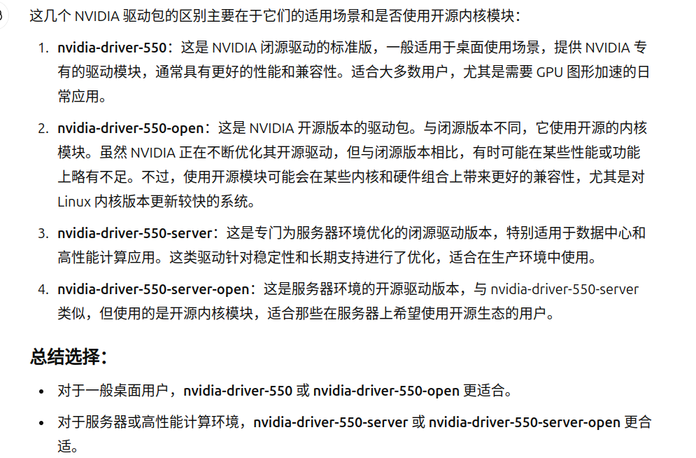

大佬厉害。学习了下:apt 包中也是有nvidia闭源驱动的。如下
$ apt search nvidia-driver
Sorting... Done
Full Text Search... Done
nvidia-driver-550/noble-security,noble-security 550.120-0ubuntu0.24.04.1 amd64
  NVIDIA driver metapackage
nvidia-driver-550-open/noble-security,noble-security 550.120-0ubuntu0.24.04.1 amd64
  NVIDIA driver (open kernel) metapackage
nvidia-driver-550-server/noble-security,noble-security 550.127.05-0ubuntu0.24.04.1 amd64
  NVIDIA Server Driver metapackage
nvidia-driver-550-server-open/noble-security,noble-security 550.127.05-0ubuntu0.24.04.1 amd64
大佬评论 get到了一个新的安装方式
大家也可以参考方法一的安装方式
apt安装方式中有它的闭源驱动我刚了解到,可以跟着upgrade更新很方便。
