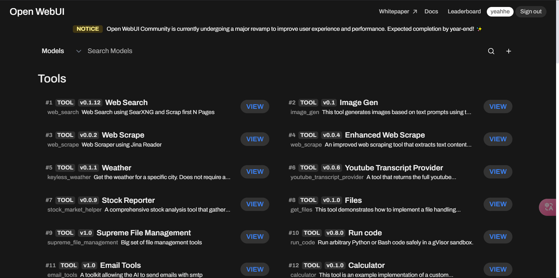

Open WebUI有什么好用的函数推荐?
蹲一个囤货
webpilot
我把排名前二十的翻译了一下
https://openwebui.com/t/2171/webpilot
这个是吧

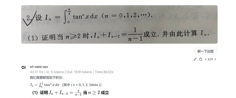

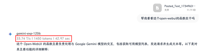

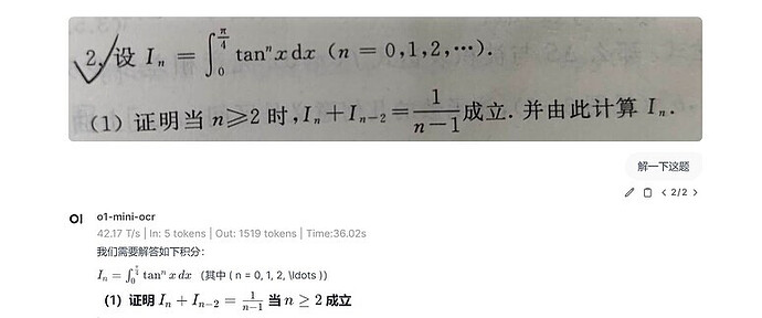

分享一下我在用的
统计token,输出速度和耗费时间
title: Chat Metrics
author: constLiakos
funding_url: https://github.com/open-webui
version: 0.0.4
license: MIT
changelog:
- 0.0.1 - Initial upload to openwebui community.
- 0.0.2 - format, remove unnecessary code
- 0.0.3 - add advanced stats: tokens & elapsed time
- 0.0.4 - each metric has its enable switch Valve, experimental metrics are disabled by default
from pydantic import BaseModel, Field
from typing import Optional, Callable, Any, Awaitable
import tiktoken
import os
import time
from open_webui.utils.misc import get_last_assistant_message
def num_tokens_from_string(user_message: str, model_name: str) -> int:
    encoding = tiktoken.encoding_for_model(model_name)
    print(encoding)
    num_tokens = len(encoding.encode(user_message))
    return num_tokens
class Filter:
    class Valves(BaseModel):
        priority: int = Field(
            default=5, description="Priority level for the filter operations."
        elapsed_time: bool = Field(
            default=True,
            description="Enable for advanced stats",
        tokens_no: bool = Field(
            default=False,
            description="Display total Tokens (Experimantal, NOT Accurate)",
        tokens_per_sec: bool = Field(
            default=False,
            description="Display Tokens per Second (Experimantal, NOT Accurate)",
        pass
    def __init__(self):
        self.valves = self.Valves()
        self.start_time = None
        pass
    def inlet(
        self,
        body: dict,
        self.start_time = time.time()
        return body
    async def outlet(
        self,
        body: dict,
        __event_emitter__: Callable[[Any], Awaitable[None]],
        __model__: Optional[dict] = None,
    ) -> dict:
        end_time = time.time()
        elapsed_time = end_time - self.start_time
        elapsed_time_str = f"Elapsed time: {elapsed_time:.2f} seconds"
        response_message = get_last_assistant_message(body["messages"])
        # model = __model__["id"]
        model = "gpt-4o"
        tokens = num_tokens_from_string(response_message, model)
        tokens_per_sec = tokens / elapsed_time
        stats_array = []
        if self.valves.tokens_per_sec:
            stats_array.append(f"{tokens_per_sec:.2f} T/s")
        if self.valves.tokens_no:
            stats_array.append(f"{tokens} tokens")
        if self.valves.elapsed_time:
            stats_array.append(f"{elapsed_time:.2f} sec")
        stats = " | ".join(stat for stat in stats_array)
        await __event_emitter__(
                "type": "status",
                "data": {
                    "description": stats,
                    "done": True,
        return body

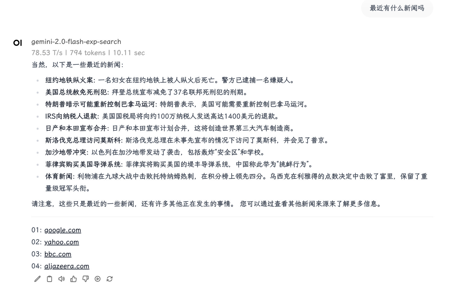

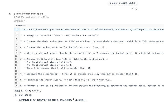

给gemini添加联网,思考模型模型的思考过程从正文分离
下面这个函数是我修改后的版本,在open-webui上面只会显示gemini-2.0-flash-thinking-expgemini-2.0-flash-exp-search两个模型

                        parts = data["candidates"][0]["content"]["parts"]
                        res = await self.do_parts(parts)
                        try:
                            if (
                                self.open_search
                                and self.valves.OPEN_SEARCH_INFO
                                and data["candidates"][0]["groundingMetadata"][
                                    "groundingChunks"
                                res += "\n---------------------------------\n"
                                groundingChunks = data["candidates"][0][
                                    "groundingMetadata"
                                ]["groundingChunks"]
                                for idx, groundingChunk in enumerate(
                                    groundingChunks, 1
                                    if "web" in groundingChunk:
                                        res += self.create_search_link(
                                            idx, groundingChunk["web"]
                        except Exception as e:
                            pass
                        await self.emit_status(message="🎉 生成成功", done=True)
                        yield res
                        return
                    else:
                        yield "No response data"
                    return
            yield f"Error: {str(e)}"
            await self.emit_status(message="❌ 生成失败", done=True)
搞个openwebui的 pipe 玩玩,直连 Gemini 付费key支持搜索,添加-search 模型分离
使不支持图像的o1-mini也能读图做数学题
import asyncio
import re
from typing import Callable, Awaitable, Any, Optional
import aiohttp
class Filter:
        priority: int = Field(default=0, description="用于过滤操作的优先级别。")
        OCR_Base_URL: str = Field(
            default="https://api.openai.com", description="LLm OCR API的基础URL。"
        OCR_API_KEY: str = Field(default="", description="API的API密钥。")
        max_retries: int = Field(default=3, description="HTTP请求的最大重试次数。")
        ocr_prompt: str = Field(
            default="Please only recognize and extract the text or data from this image without interpreting, analyzing, or understanding the content. Do not output any additional information. Simply return the recognized text or data content.",
            description="进行OCR识别的提示词",
        model_name: str = Field(default="gemini-1.5-flash-latest", description="用于OCR图像的模型名称。推荐使用gemini系列")
    def __init__(self):
    async def _perform_ocr(
        self, image: str, event_emitter: Callable[[Any], Awaitable[None]]
    ) -> str:
        """执行OCR识别的内部方法"""
        await event_emitter(
                "type": "status",
                "data": {
                    "description": "✨正在对图像进行文字识别中,请耐心等待...",
                    "done": False,
        headers = {
            "Content-Type": "application/json",
            "Authorization": f"Bearer {self.valves.OCR_API_KEY}",
        ocr_body = {
            "model": self.valves.model_name,
            "messages": [
                    "role": "system",
                    "content": [{"type": "text", "text": self.valves.ocr_prompt}],
                    "role": "user",
                    "content": [
                            "type": "image_url",
                            "image_url": {"url": image, "detail": "high"},
        url = f"{self.valves.OCR_Base_URL}/v1/chat/completions"
        async with aiohttp.ClientSession() as session:
            for attempt in range(self.valves.max_retries):
                try:
                    async with session.post(
                        url, json=ocr_body, headers=headers
                    ) as response:
                        response.raise_for_status()
                        response_data = await response.json()
                        result = response_data["choices"][0]["message"]["content"]
                                "type": "status",
                                "data": {
                                    "description": "🎉识别成功,交由模型进行处理...",
                                    "done": True,
                        return result
                    if attempt == self.valves.max_retries - 1:
                        raise RuntimeError(f"OCR识别失败:{e}")
    async def inlet(
        self,
        body: dict,
        __user__: Optional[dict] = None,
    ) -> dict:
        messages = body.get("messages", [])
        # 查找图像
        image_info = self._find_image_in_messages(messages)
        if not image_info:
            return body
        message_index, content_index, image = image_info
        # 如果已经是第二轮及以上对话,直接返回
        if (len(messages) // 2) >= 1:
            del messages[message_index]["content"][content_index]
            body["messages"] = messages
            return body
        try:
            # 执行OCR识别
            result = await self._perform_ocr(image, __event_emitter__)
            # 更新消息内容
            messages[message_index]["content"][content_index]["type"] = "text"
            messages[message_index]["content"][content_index].pop("image_url", None)
            messages[message_index]["content"][content_index]["text"] = result
            print(f"OCR识别错误: {e}")
            # 可以根据需要进行错误处理
        return body
    def _find_image_in_messages(self, messages):
        """在消息中查找图像"""
        for m_index, message in enumerate(messages):
            if message["role"] == "user" and isinstance(message.get("content"), list):
                for c_index, content in enumerate(message["content"]):
                    if content["type"] == "image_url":
                        return m_index, c_index, content["image_url"]["url"]
        return None
    async def outlet(
        self,
        body: dict,
    ) -> dict:
        return body
使用方式:在Openwebui中对传入的图片进行文字识别后再交给模型处理
