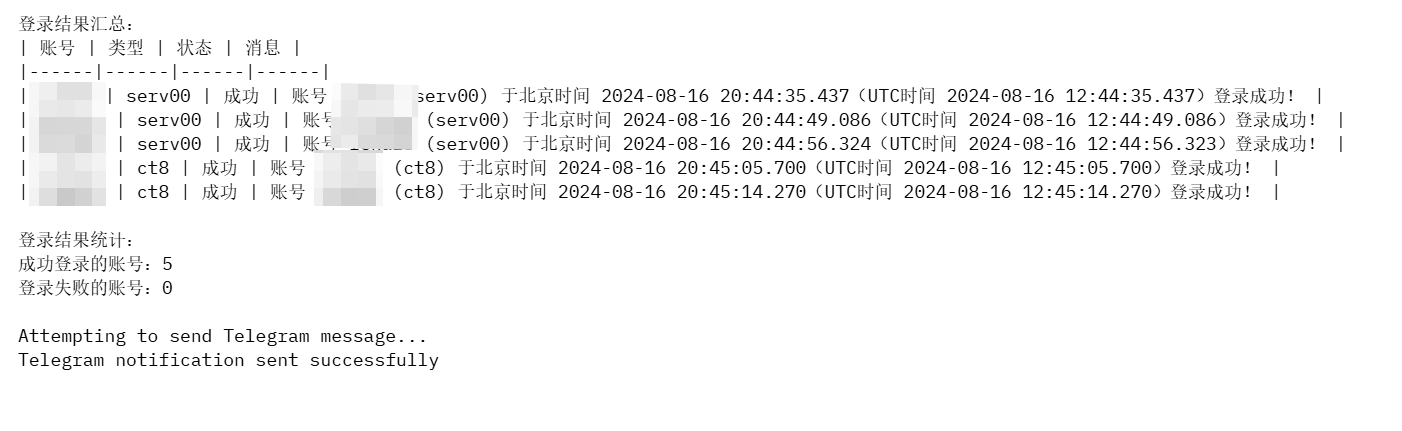

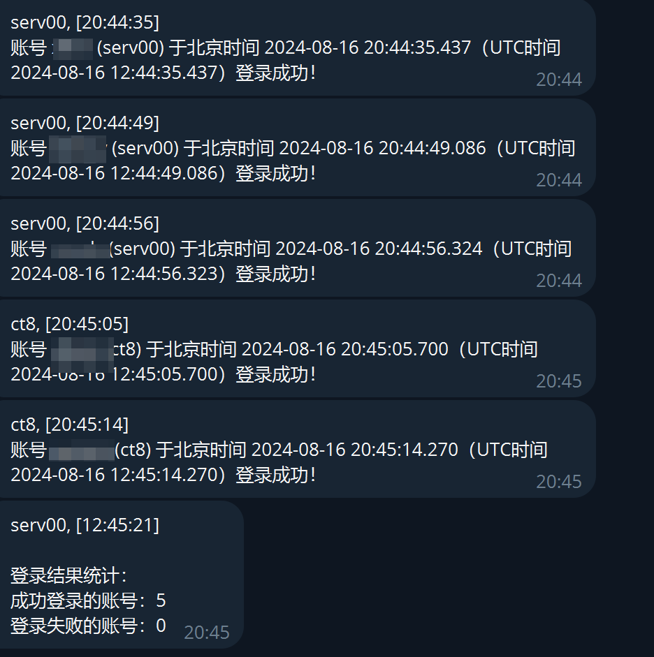

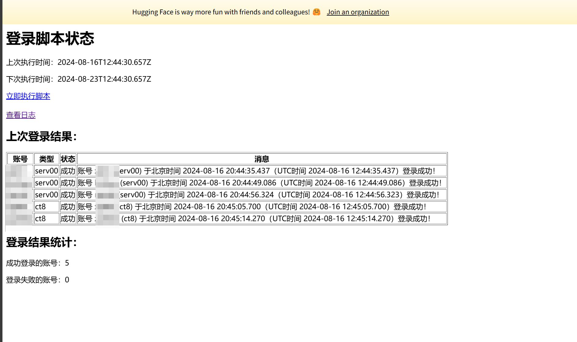

在佬友 @Coker 的提点下,在huggingface成功加入telegram通知账号登录状态
废话不多说,先上效果图
hugging的logs:
访问huggingface网页:
telegram中:

async function sendTelegramMessage(message) {
  if (!telegramConfig || !telegramConfig.cloudflareWorkerUrl || !telegramConfig.telegramBotToken || !telegramConfig.telegramBotUserId || !telegramConfig.customAuthKey) {
    console.log('Telegram configuration not set or incomplete, skipping notification');
    return;
  console.log('Attempting to send Telegram message...');
  const url = `${telegramConfig.cloudflareWorkerUrl}/${telegramConfig.telegramBotToken}/sendMessage`;
  try {
    const response = await axios.post(url, {
      chat_id: telegramConfig.telegramBotUserId,
      text: message
      headers: {
        'X-Custom-Auth': telegramConfig.customAuthKey
    console.log('Telegram notification sent successfully');
  } catch (error) {
    console.error('Error sending Telegram notification:', error.response ? error.response.data : error.message);

  console.log('\n登录结果汇总:');
  console.log('| 账号 | 类型 | 状态 | 消息 |');
  console.log('|------|------|------|------|');
  results.forEach(({ username, type, success, message }) => {
    console.log(`| ${username} | ${type} | ${success ? '成功' : '失败'} | ${message} |`);
  let summaryMessage = '\n登录结果统计:\n';
  summaryMessage += `成功登录的账号:${successfulLogins.length}\n`;
  summaryMessage += `登录失败的账号:${failedLogins.length}\n`;
  if (failedLogins.length > 0) {
    summaryMessage += '\n登录失败的账号列表:\n';
    failedLogins.forEach(({ username, type }) => {
      summaryMessage += `- ${username} (${type})\n`;
  console.log(summaryMessage);
  await sendTelegramMessage(`${accounts[0].type}, [${formatToISO(new Date()).split(' ')[1].split('.')[0]}]\n${summaryMessage}`);

给出两个版本,第一个版本访问huggingface网页不会显示你的账号登录信息,适用于不想别人知道serv00/ct8账号名的佬友,第二种适用于想通过访问huggingface网站就能直接获取账号登录信息的佬友

有网页账号信息
const express = require('express');
const { exec } = require('child_process');
const fs = require('fs');
const path = require('path');
const app = express();
const port = process.env.PORT || 8080;
// 使用 HOME 环境变量来创建日志目录
const logDir = path.join(process.env.HOME, 'logs');
if (!fs.existsSync(logDir)) {
    fs.mkdirSync(logDir, { recursive: true });
let lastRunTime = null;
let nextRunTime = null;
let lastRunResults = null;
function log(message) {
    const timestamp = new Date().toISOString();
    const logMessage = `${timestamp}: ${message}\n`;
    console.log(logMessage);
    fs.appendFileSync(path.join(logDir, 'app.log'), logMessage);
app.get('/', (req, res) => {
    let tableHtml = '';
    let summaryHtml = '';
    if (lastRunResults) {
        tableHtml = '<h2>上次登录结果:</h2>';
        tableHtml += '<table border="1"><tr><th>账号</th><th>类型</th><th>状态</th><th>消息</th></tr>';
        lastRunResults.forEach(result => {
            tableHtml += `<tr><td>${result.username}</td><td>${result.type}</td><td>${result.success ? '成功' : '失败'}</td><td>${result.message}</td></tr>`;
        tableHtml += '</table>';
        const successfulLogins = lastRunResults.filter(r => r.success);
        const failedLogins = lastRunResults.filter(r => !r.success);
        summaryHtml = '<h2>登录结果统计:</h2>';
        summaryHtml += `<p>成功登录的账号:${successfulLogins.length}</p>`;
        summaryHtml += `<p>登录失败的账号:${failedLogins.length}</p>`;
            summaryHtml += '<h3>登录失败的账号列表:</h3><ul>';
                summaryHtml += `<li>${username} (${type})</li>`;
            summaryHtml += '</ul>';
    res.send(`
        <h1>登录脚本状态</h1>
        <p>上次执行时间:${lastRunTime || '尚未执行'}</p>
        <p>下次执行时间:${nextRunTime || '未设置'}</p>
        <a href="/run">立即执行脚本</a>
        <br><br>
        <a href="/logs">查看日志</a>
        ${tableHtml}
        ${summaryHtml}

        if (err) {
            res.status(500).send('无法读取日志文件');
            return;
        res.send(`<pre>${data}</pre>`);
function runLoginScript() {
    log('开始执行登录脚本');
    exec('node login.js', (error, stdout, stderr) => {
        if (error) {
            log(`执行错误: ${error.message}`);
            return;
        if (stderr) {
            log(`脚本错误输出: ${stderr}`);
            return;
        log(`脚本输出:\n${stdout}`);
        // 解析输出以获取结果
        const lines = stdout.split('\n');
        const resultStartIndex = lines.findIndex(line => line.includes('| 账号 | 类型 | 状态 | 消息 |'));
        if (resultStartIndex !== -1) {
            lastRunResults = lines.slice(resultStartIndex + 2)
                .filter(line => line.trim().startsWith('|'))
                .map(line => {
                    const [, username, type, status, message] = line.split('|').map(item => item.trim());
                    return { username, type, success: status === '成功', message };
    lastRunTime = new Date().toISOString();
    nextRunTime = new Date(Date.now() + 7 * 24 * 60 * 60 * 1000).toISOString();
app.get('/run', (req, res) => {
    runLoginScript();
    res.send('脚本执行已启动,请稍后刷新页面查看结果。');
// 每7天自动运行一次脚本
setInterval(runLoginScript, 7 * 24 * 60 * 60 * 1000);
app.listen(port, () => {
    log(`服务器运行在 http://localhost:${port}`);
    runLoginScript(); // 启动时立即运行一次

cloudflare的worker脚本
addEventListener('fetch', event => {
  event.respondWith(handleRequest(event.request))
async function handleRequest(request) {
  // 确保请求方法是 POST
  if (request.method !== 'POST') {
    return new Response('Only POST requests are allowed', { status: 405 })
  // 从请求 URL 中提取 bot token 和方法
  const url = new URL(request.url)
  const pathParts = url.pathname.split('/')
  const botToken = pathParts[1]
  const method = pathParts[2]
  // 验证自定义认证头
  const authHeader = request.headers.get('X-Custom-Auth')
  if (authHeader !== 'your-secret-key') {
    return new Response('Unauthorized', { status: 401 })
  // 构建 Telegram API URL
  const telegramUrl = `https://api.telegram.org/bot${botToken}/${method}`
  // 转发请求到 Telegram API
  const telegramResponse = await fetch(telegramUrl, {
    method: 'POST',
    headers: {
      'Content-Type': 'application/json',
    body: request.body
  // 返回 Telegram 的响应
  return new Response(telegramResponse.body, {
    status: telegramResponse.status,
    headers: telegramResponse.headers
your-secret-key头部改为你自己想设置的,避免别人滥用你的反代
worker需要使用自定义域名,只有这样huggingface才能请求
huggingface后台变量:
ACCOUNTS_JSON
  { "username": "serv00user1", "password": "serv00password1", "panelnum": "0", "type": "serv00" },
  { "username": "serv00user2", "password": "serv00password2", "panelnum": "4", "type": "serv00" },
  { "username": "serv00user3", "password": "serv00password3", "panelnum": "7", "type": "serv00" },
  { "username": "ct8user1", "password": "ct8password1", "type": "ct8" },
  { "username": "ct8user2", "password": "ct8password2", "type": "ct8" }
TELEGRAM_JSON
  "cloudflareWorkerUrl": "https://你CF worker域名",
  "telegramBotToken": "YOUR_BOT_TOKEN",
  "telegramBotUserId": "YOUR_USER_ID",
  "customAuthKey": "你设置的头部"

脚本每七天自动登录一次
最后,由于huggingface不定期访问会休眠,所以需要加个定时任务,下面的随便选一个进行保活即可。
https://console.rapjob.com/
