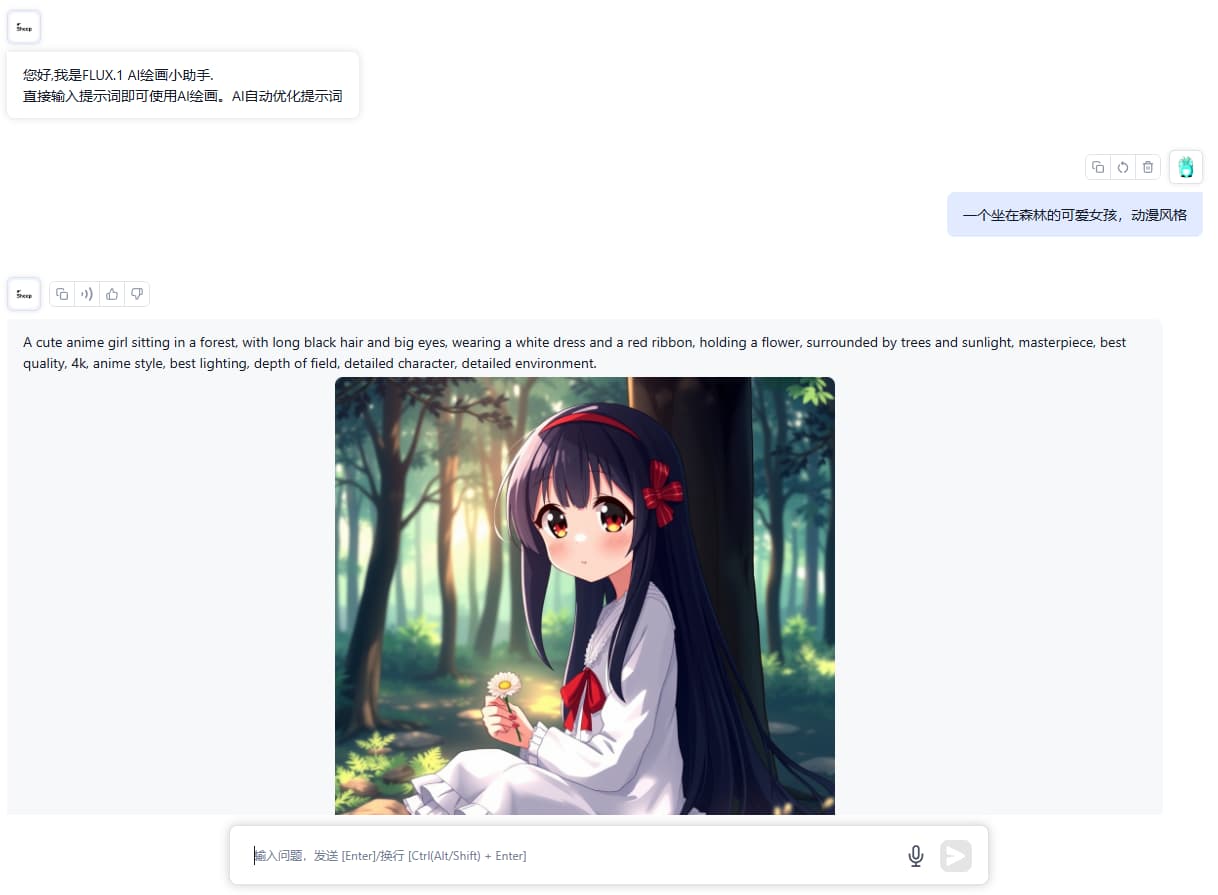

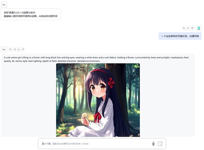

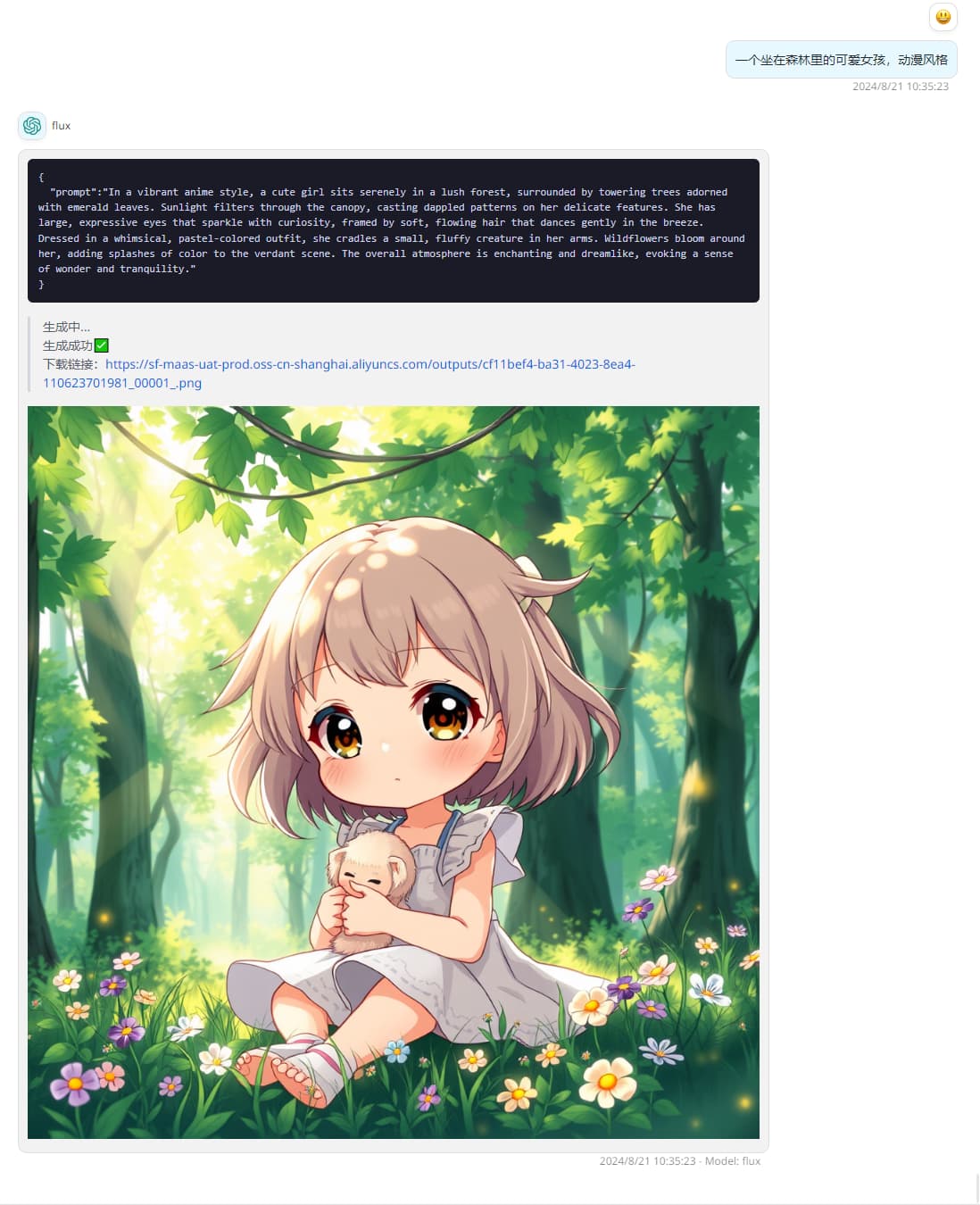

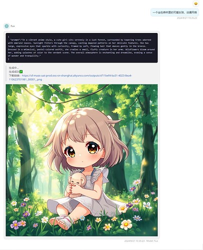

效果展示:
直接输入中文提示词即可,会生成对应英文提示词

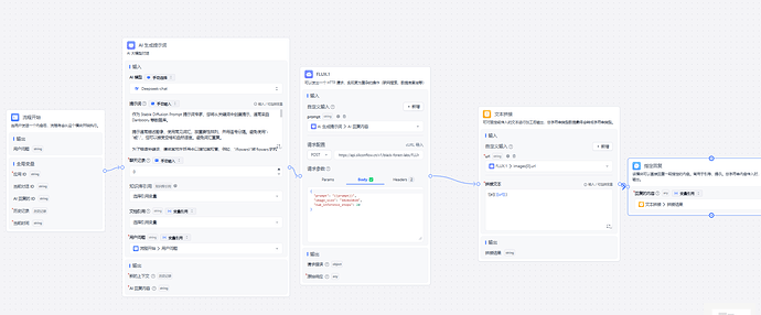

工作流展示:

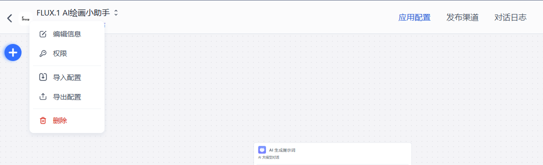

部署教程:

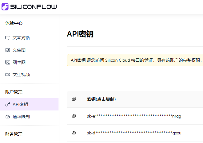

先在 AFF 硅基流动 含aff中注册,生成api key,复制备用。
接着去fastgpt创建工作流,并导入我的工作流如下:

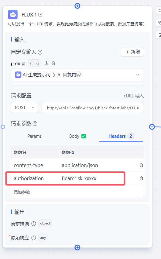

      "nodeId": "szqvHMArA7rG",
      "name": "FLUX.1",
      "intro": "可以发出一个 HTTP 请求,实现更为复杂的操作(联网搜索、数据库查询等)",
      "avatar": "core/workflow/template/httpRequest",
      "flowNodeType": "httpRequest468",
      "showStatus": true,
      "position": {
        "x": 2097.395110695174,
        "y": 1268.0575222390357
      "version": "481",
      "inputs": [
          "key": "system_addInputParam",
          "renderTypeList": [
            "addInputParam"
          "valueType": "dynamic",
          "label": "",
          "required": false,
          "description": "core.module.input.description.HTTP Dynamic Input",
          "editField": {
            "key": true,
            "valueType": true
          "customInputConfig": {
            "selectValueTypeList": [
              "string",
              "number",
              "boolean",
              "object",
              "arrayString",
              "arrayNumber",
              "arrayBoolean",
              "arrayObject",
              "any",
              "chatHistory",
              "datasetQuote",
              "dynamic",
              "selectApp",
              "selectDataset"
            "showDescription": false,
            "showDefaultValue": true
          "key": "system_httpMethod",
          "renderTypeList": [
            "custom"
          "valueType": "string",
          "label": "",
          "value": "POST",
          "required": true
          "key": "system_httpTimeout",
          "renderTypeList": [
            "custom"
          "valueType": "number",
          "label": "",
          "value": 30,
          "min": 5,
          "max": 600,
          "required": true
          "key": "system_httpReqUrl",
          "renderTypeList": [
            "hidden"
          "label": "",
          "description": "core.module.input.description.Http Request Url",
          "placeholder": "https://api.ai.com/getInventory",
          "required": false,
          "value": "https://api.siliconflow.cn/v1/black-forest-labs/FLUX.1-schnell/text-to-image"
          "key": "system_httpHeader",
          "renderTypeList": [
            "custom"
          "valueType": "any",
          "value": [
              "key": "content-type",
              "type": "string",
              "value": "application/json"
              "key": "authorization",
              "type": "string",
              "value": "Bearer sk-xxxxx"
          "label": "",
          "description": "core.module.input.description.Http Request Header",
          "placeholder": "core.module.input.description.Http Request Header",
          "required": false
          "key": "system_httpParams",
          "renderTypeList": [
            "hidden"
          "valueType": "any",
          "value": [],
          "label": "",
          "required": false
          "key": "system_httpJsonBody",
          "renderTypeList": [
            "hidden"
          "valueType": "any",
          "value": "{\r\n  \"prompt\": \"{{prompt}}\",\r\n  \"image_size\": \"1024x1024\",\r\n  \"num_inference_steps\": 28\r\n}",
          "label": "",
          "required": false

导入方式如下:
接着来到图中所示空处,将sk-xxxxxxx换成你的之前提到的api kay
(可选)以上工作流调用的是FLUX.1,如果想使用SD3绘画的话,在上图中,点击cURL导入,输入以下内容即可:
curl --request POST \
     --url https://api.siliconflow.cn/v1/stabilityai/stable-diffusion-3-medium/text-to-image \
     --header 'accept: application/json' \
     --header 'authorization: Bearer sk-xxxxxxxxx' \
     --header 'content-type: application/json' \
     --data '
  "prompt": "{{prompt}}",
  "image_size": "1024x1024",
  "batch_size": 1,
  "num_inference_steps": 20,
  "guidance_scale": 7.5

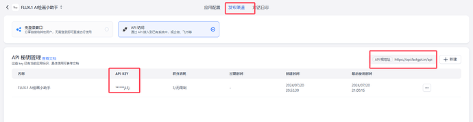

接入NEW API

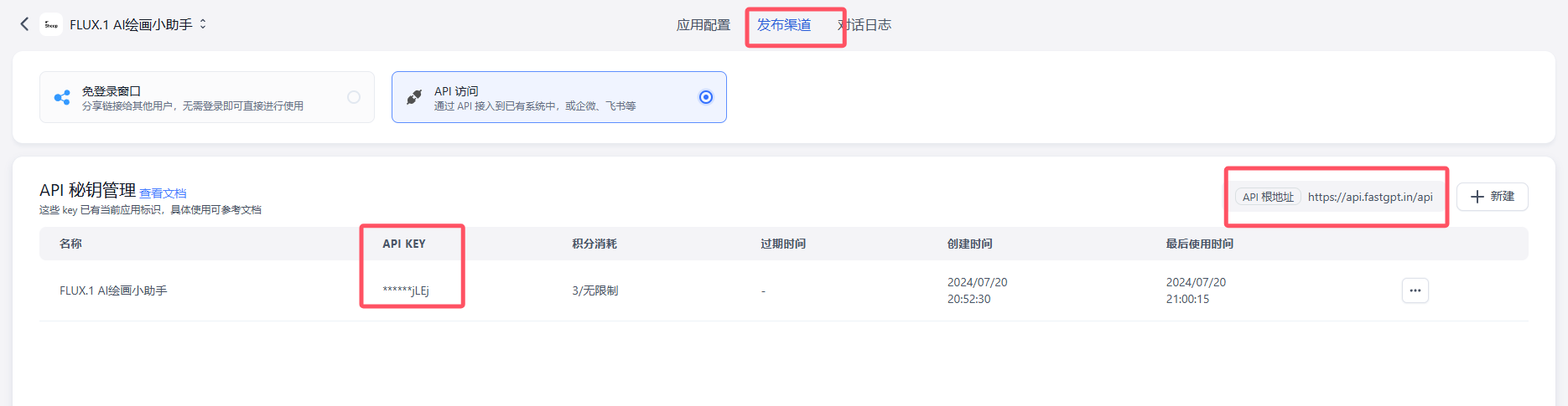

在fastgpt点击发布渠道,然后记录下图中两个红框的值,另外发布渠道中也可以直接创建我下面那样的分享链接

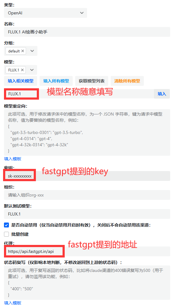

来到NEW API填写相关信息即可,兼容open ai接口
大功告成

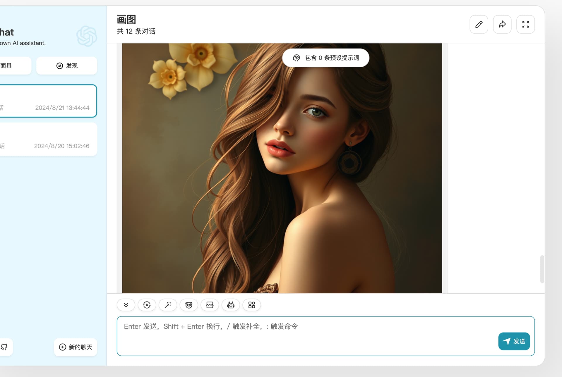

这是我搭建好的,大家可以试试:效果展示 (已屏蔽nsfw的内容)
